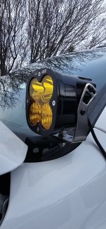

Wanting more light, my first add on was going to be in the A-Pillar position on the truck and commonly called "Ditch Lights". I began this add on by searching for some appropriate and Made in USA brackets. I wanted to find some brackets that were beefy as I was going to add heavier lights (Baja Designs XL80S) to them.
I scoured the internet looking at different ones. I eventually settled on the A-Pillar brackets from SDHQ in Gilbert, Az. These brackets are CNC cut and mandrel bent in house. They are then powdercoated black.
Were they the cheapest? No. Chineseum sucks!!
Were they the easiest install? No. Didn't want that either.
Heres the link to the bracket:
https://sdhqoffroad.com/products/10-18-ram-2500-3500-sdhq-built-a-pillar-light-mounts
This link is for the 2500-3500 but the same item ID pops up for the 1500 and is mentioned in the instructions. Some install parts are 1500 specific.
The brackets come packaged in a appropriate size box (have you seen some Amazon boxed items) and supported with foam molded to the brackets. In addition to the brackets come the appropriate hardware to install them on 2010-2018 Ram 1500-3500 Trucks.
In the box you also get a list of included parts and on that list is a QR code you can scan to get the printable install instructions (also available directly on the website).
Install begins with that almighty 10mm socket on a 1/4" ratchet or compact impact (I used my M12 Milwaukee Impact)
Instructions have you trimming approximately 1/4" off each side including removing the windshield washer tube retaining clip. I used the combo of a Dremel with a cutoff wheel and a fresh blade on a razor knife for each side. I marked it with a silver sharpie for ease of visibility.
After cutting the trip away and going as far back to beneath the windshield the bracket slides into place with a little manipulation. I held it in place with the 10mm fender bolt.
The bracket sits around 1/8" from the hood
The bracket is further held in place by adding a Grade 8-5/16" x 18 bolt in the rear hinge brace hole.
The kit includes standard nuts. I had Nylok nuts on hand so replaced the standard nuts with those. No torque specs were included so I just made them "tight".
This photo shows some of the required cowl trimming on both sides to fit the brackets.
The brackets provide two mounting positions for lights. I'll see once I install the lights how each position looks and fits best.
Finishing wasn't hard at all. Instructions say it takes 2 hours. I completed it in 1.5 hrs. These instructions aren't bad but could use some work and to those with minimal mechanical knowledge I could see this taking longer.
Overall though I wouldn't hesitate to purchase these again or other items from SDHQ again.
