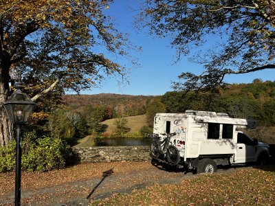

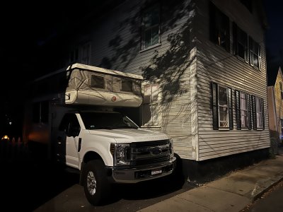

2019 F250, 10,000 GVWR, 6.2 Gas, 6 Speed, 4.30 elocker, STX, Vinyl interior, Plow/Camper package, 360 Camera, Knapheide Steel Flatbed, PMF Trackbar, 37x11.5x18 Nitto Ridge Grapplers
I had been on the hunt for this specific truck for a year and a half. I purchased it sight unseen in Scottsdale, AZ and spent a few weeks driving it home. Went down to Tucson and came up through Telluride and over to Silverton on Ophir, Black Canyon of the Gunnison, Aspen, Boulder and then pretty much a straight shot back home to Massachusetts. Not too many mods so far, rear facing work lights and reverse lights on the upfitter switches and relayed in with reverse. Put in a PMF Trackbar after front end parts were starting to get a little play. Found a set of 37s on Marketplace for $550 mounted and balanced

The camper is a 2008 Hallmark UTE XS, Electric lifting Composite roof, Coleman Mach-8 9K AC, Racks, Ladder, Hot Water, Dometic 3way fridge, 3 burner stove, Side awning, Two CR-236 6Volt batteries. I have always wanted a Hallmark or Outfitter, but my preference for regular cab trucks kept me to an east-west bed layout. I remember seeing this camper come up for sale over the winter for a steal and had forgotten about it till it came back up on the Hallmark Truck Camper Owners Facebook group. I dragged my feet a bit and almost missed out on it, but things fell in place and I became the third owner in June this year

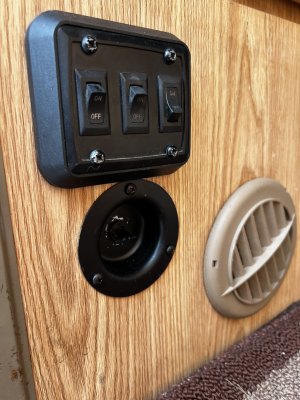

Currently straightening out the bathroom door jam
