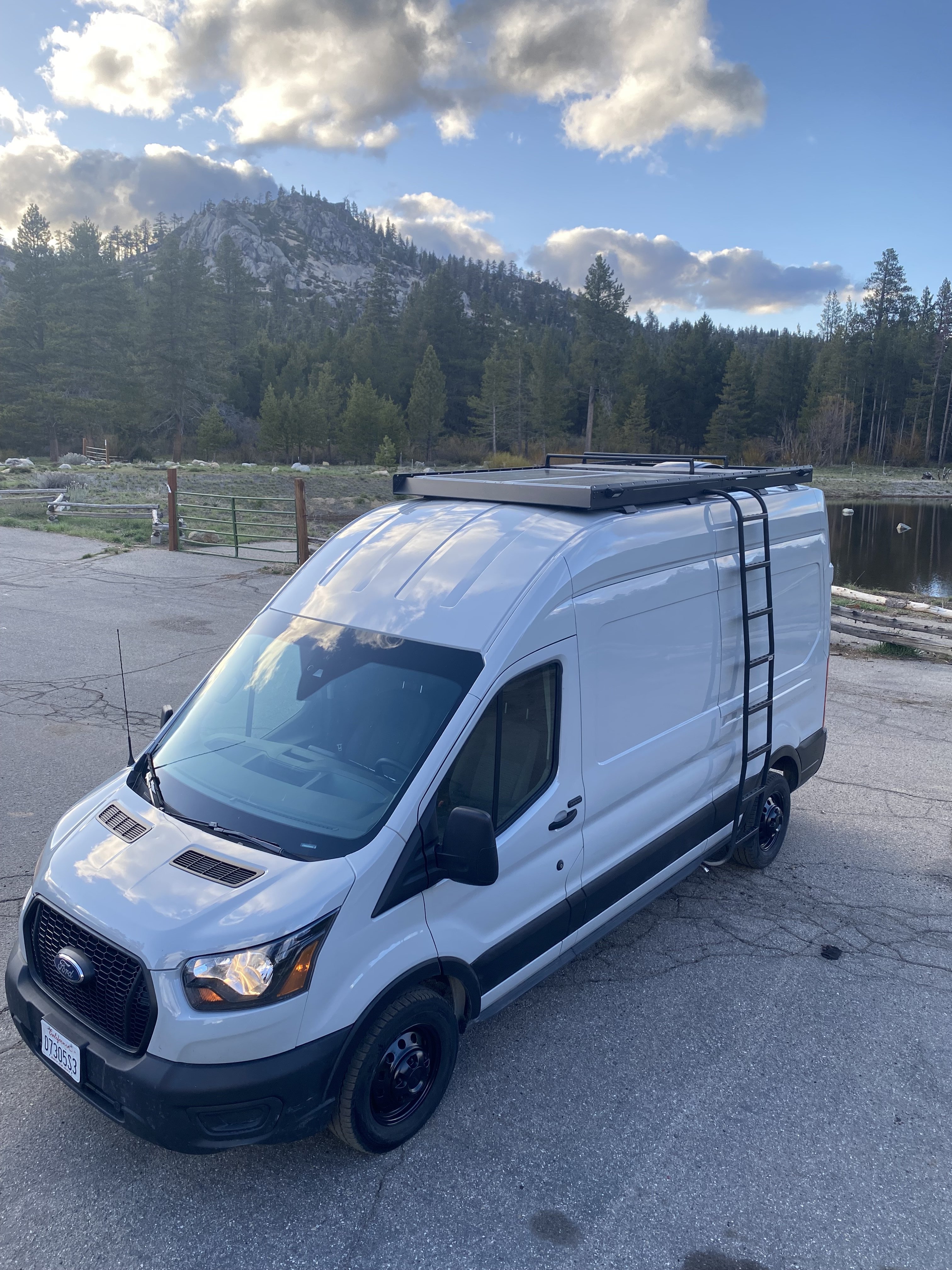

  • Flatline Van Company LoPro Roof Rack
  • Flatline Van Company Front Fairing
  • Flatline Van Company Side Ladder
  • Max Air Fan 7500K (Mounted with @hein 's rearmost adapter)
  • 16.5" x 58" Surf Check Deck"(TimberTech Azek Decking)
  • (2x) Flatline Van Company Crossbars
  • (4x) Rigid 1x2 65 Degree Scene Lights (Controlled by interior on/off switch)
  • (2x) NewPowa Solar 200 Watt (12v) Monocrystaline Panels

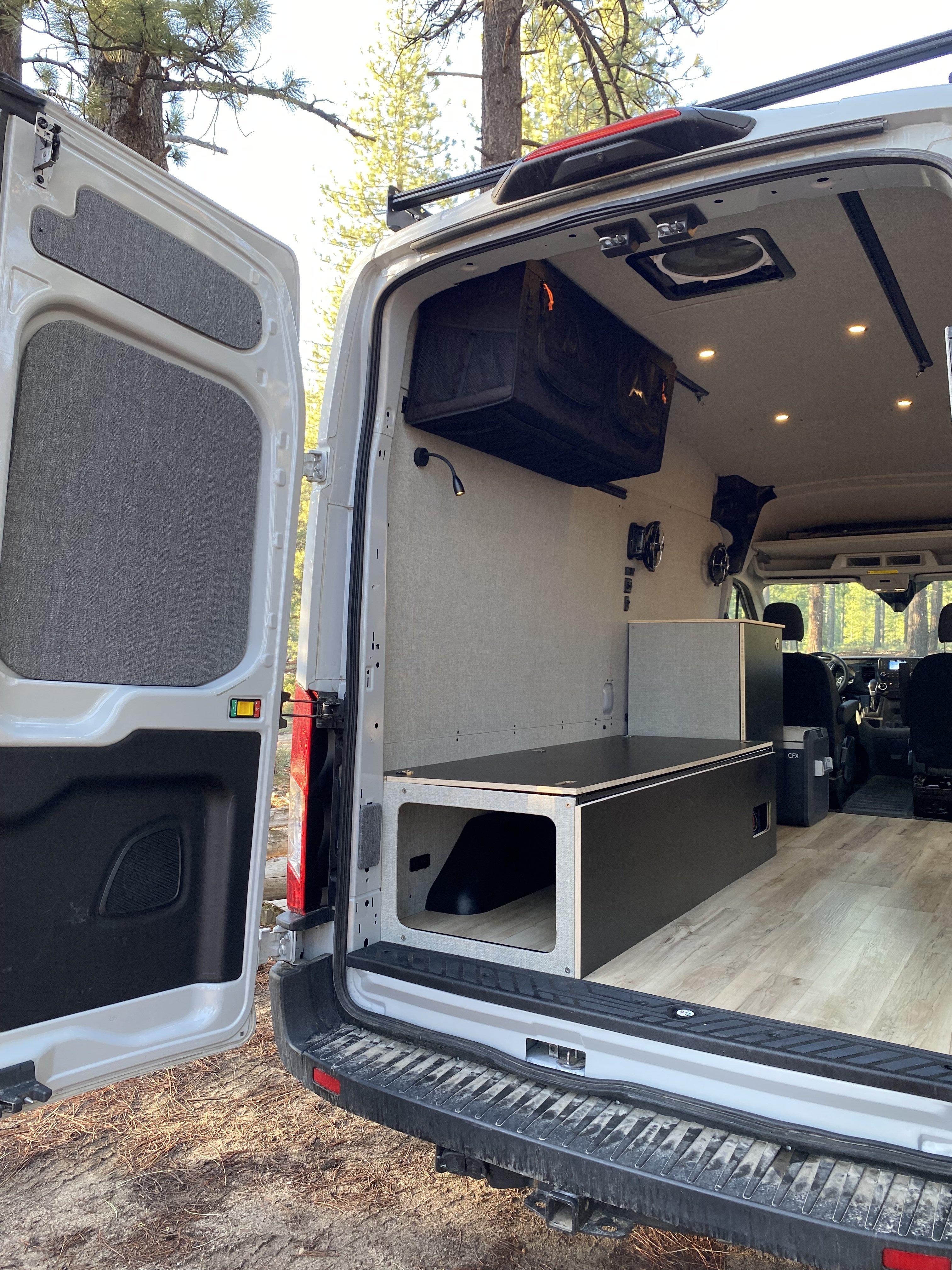

Interior
  • Custom Vancillary Overhead Shelf (5/8" Baltic Birch + Marathon Wool)
  • Complete 3M Thinsulate Insulation
  • 1/4" ArrowPly Birch Wall/Ceiling Panels (+Marathon Wool)
  • AVC Rig Wall to Ceiling Supports
  • (6) Dimmer Controlled LED Ceiling Lights
  • (4) Dimmer Controlled LED Garage Lights
  • (2) Accessory USB/12v (Cigarette) Outlets
  • (1) Accessory 12v (Cigarette) Outlet
  • (3) Sirocco II Fans by Cafarmo
  • Custom Surface Mounted L Track by Tec Vanlife CA (Adventure Wagon Dimensions)
  • (1) Adventure Wagon Mule Bag
  • Goal Zero 1500X Power Station
  • Goal Zero Car Link (V2)
  • Custom PowerWerx Solar Cable
  • Custom PowerWerx Anderson Connector Cable
  • Blue Sea (5026 ST) Blade Fuse Block
  • Espar Airtronic M2-B4L (with Ford Transit Standpipe) via Espar Parts Michigan
  • Dometic Two-Burner Cooktop
  • Custom (15 Series) 80/20 Galley (Bamboo Countertop & Door with WilsonArt Laminate)
  • 40" x 76" Folding Mattress for the "Bed"
  • 25" x 76" Folding Mattress for the "Couch"
  • (Removable) Dometic CFX3 53L Fridge
  • One of a Kind Couch/Bed (15 Series 80/20, 5/8" Baltic Birch Plywood, 1/4" ArrowPly Birch, Marathon Wool, & WilsonArt Laminate)
  • Custom Rear Door Insulation Panels (Sunbrella)
  • 1/2" ArrowPly Birch Subfloor and Luxury Vinyl Plank Flooring
  • (2) Adjustable (12v) Reading/Mood Lights

The Roof
The Flatline Van Company roof rack is the foundation of our exterior build out. Here in Tahoe it's essential that we have a way to clear snow off of the roof. I have not seen a better solution for snow maintenance than a side mounted ladder. A rear mounted ladder does not allow for pushing snow off the front half of the van - the most critical for safe travel living in an area with snow. This process is made even easier with our roof top "maintenance/surf check" deck. I can walk up the ladder, sweep snow from the deck, stand on the deck, and continue pushing snow off of the van from there. It is safe and effective. The alternative is driving around town with up 30" of snow on the roof of the van like a **************.
The side ladder leads directly to the deck with access to the FVCO cross bars. Standing on the deck, it's simple to strap surfboards/anything else to the cross bars without standing directly on the thin sheet metal of the van roof. Without the deck, taking/strapping things on and off the cross bars isn't very realistic. I installed cross bars from FVCO made for the Sprinter that are shorter than the full-width Transit bars to allow for easy access getting onto and off of the roof deck.
The four exterior lights (controlled by an on/off switch inside the van) are one of my favorite features. Everyone loves them at camp when the fire danger is too high for a campfire but we'd like to stay outside hanging out after dark. A lot of folks copy the Winnebago (Revel) and mount them directly to the van body but in my opinion, any time I can avoid drilling new holes into the exterior I do. If you start paying attention you'll see plenty of crooked and unlevel exterior lights on vans. The lights are much better suited for long term use when mounted directly to the FVCO roof rack. This also means the wiring is accessible for maintenance instead of buried behind the insulation/walls of the van.
We've got 400 total watts of solar on this build. The two 200 watt panels from NewPowa fit perfectly on this rack. Mounting them all the way forward means that clearing snow off of the front of the van with a large broom is very quick and simple. The front 1/5th of the roof rack sits over the area of the van where you cannot mount a fan so it makes sense to fill that space with solar. The idea behind having 400 watts of solar is to keep our batteries at 100% all day long so that we go into the evening fully charged. That means we want to run our MaxAir Fan, interior fans, fridge, and charge any devices we have while the van is stationary. Another benefit of having more solar than we "need" is that we can cover up the majority of one panel when our longboard surfboards are on the roof and still have another panel to charge the battery.

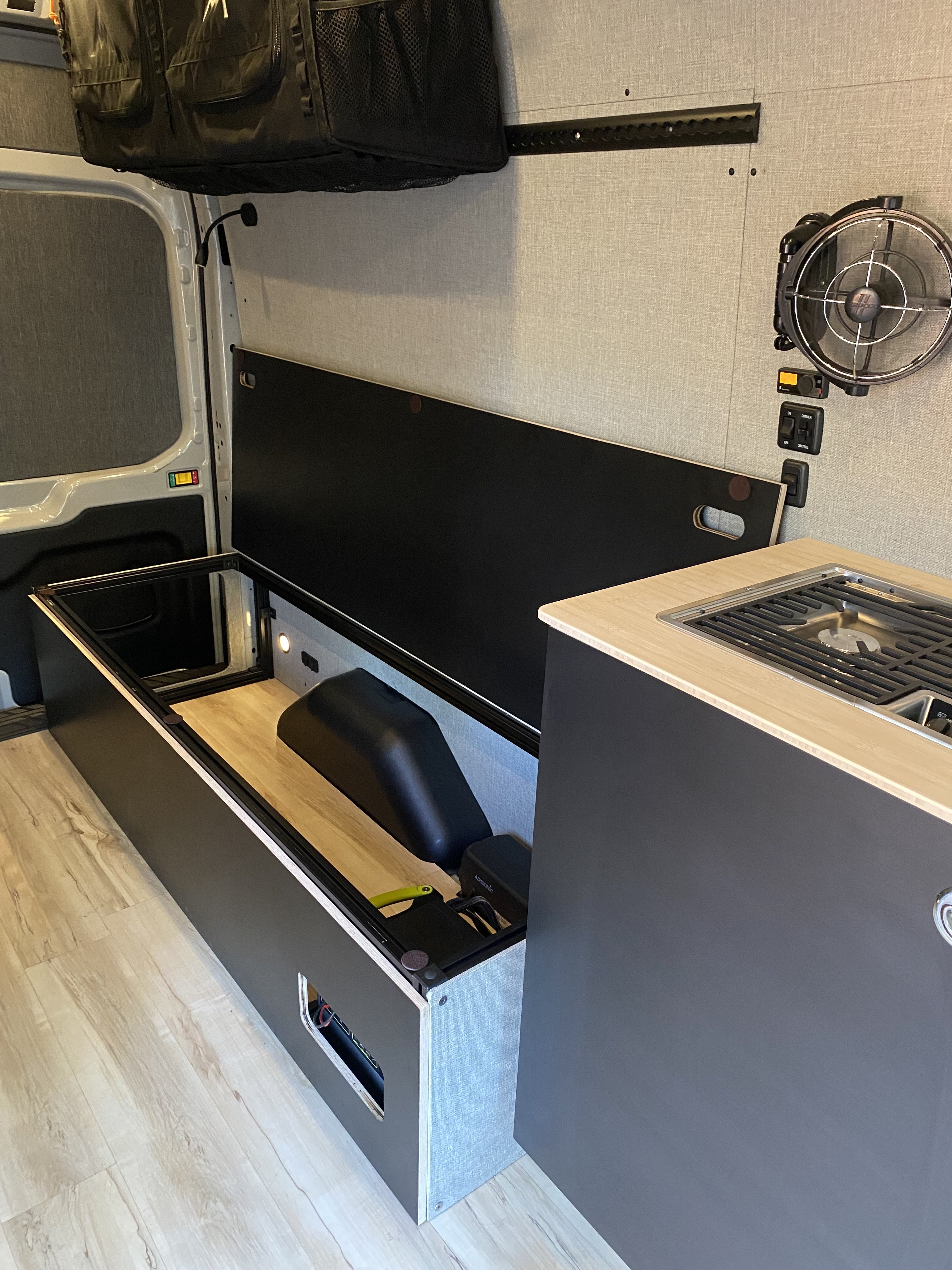

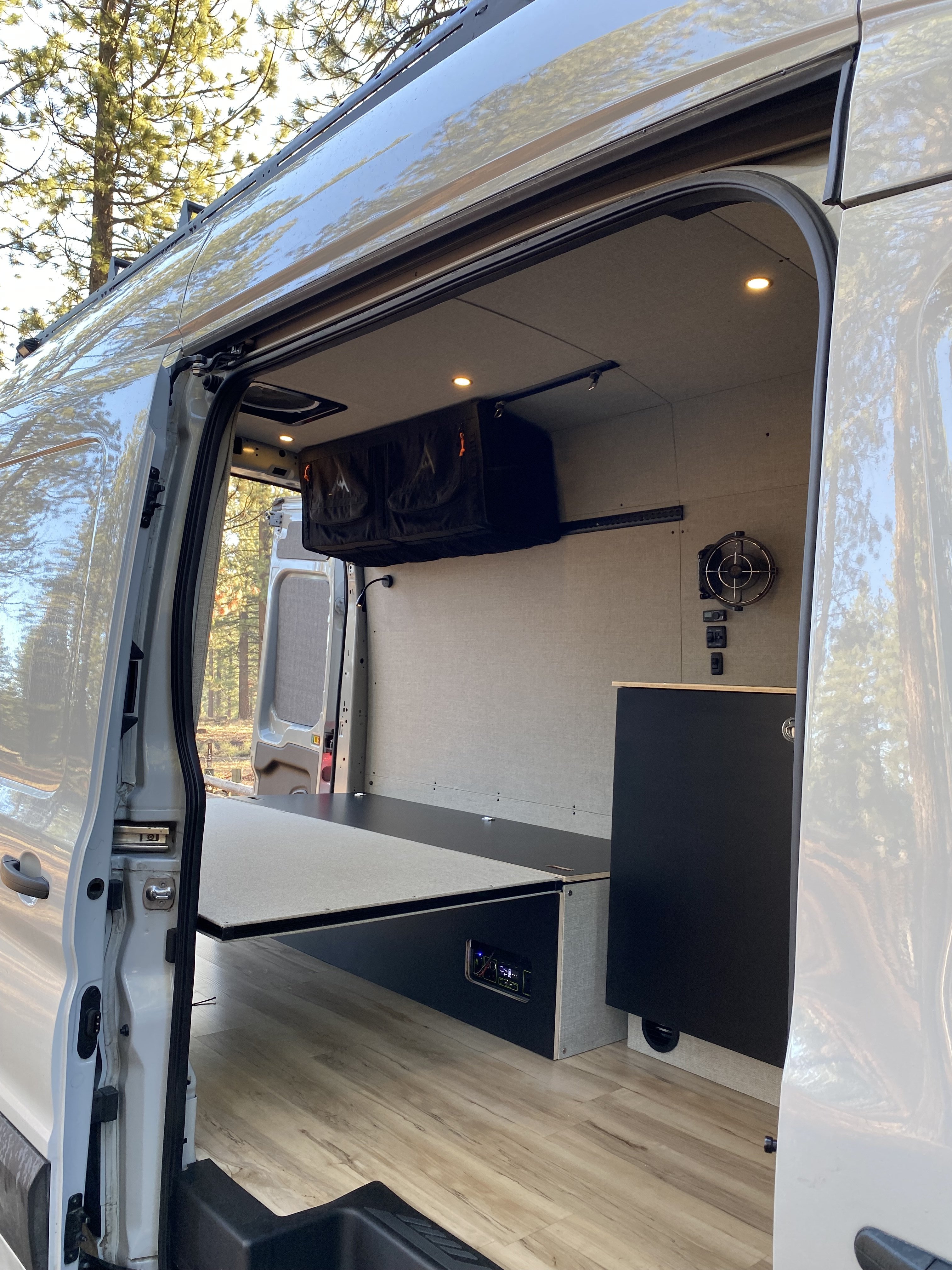

The Couch/Bed
There isn't much space in a non-extended Transit. In my personal opinion, installing a permanent bed that takes up 60% or more of that usable space is a great way to make sure that you won't have much space to move around in the van - especially after installing a galley. Flarespace flares are nice but they still prevent you from being able to walk from the front of the van to the back of the van. Once you've experienced a van without a full-time bed it's hard to sacrifice all of that usable space. That's why I came up with this design. In reality, we spend more time using our van as a space to hang out/get ready for activities than we do sleeping - we've got a house to sleep in. Whether we're getting ready to snowboard or go surf, having all that open space plus a place to sit down and get ready is amazing for our lifestyle. Getting back from a long day and being able to get into the van and sit on the couch and relax is an awesome luxury. The bed side and the couch side both have 4" mattresses that fit them perfectly. The hinges on both sides were built to accommodate the thickness of the mattresses when the bed is folded up and the couch lid is lifted for access to the storage beneath. The bed is very light weight and easily managed by one person. There is no need for a second person whatsoever to fold the bed up and regain all that square footage of the van. A solo traveler could easily sleep on the "couch" side with the single sized mattress (76" x 30"). The "bed" side has a full size mattress (76" x 38"). Combined the bed that is created is huge and very comfortable.
The couch is constructed with 15 series 80/20, 1/4" ArrowPly + Marathon wool, 5/8" Baltic birch plywood + WilsonArt laminate, and stainless steel marine hinges. The bed is constructed with 10 series80/20, 1/4" ArrowPly + Marathon wool, and powder coated hinges.

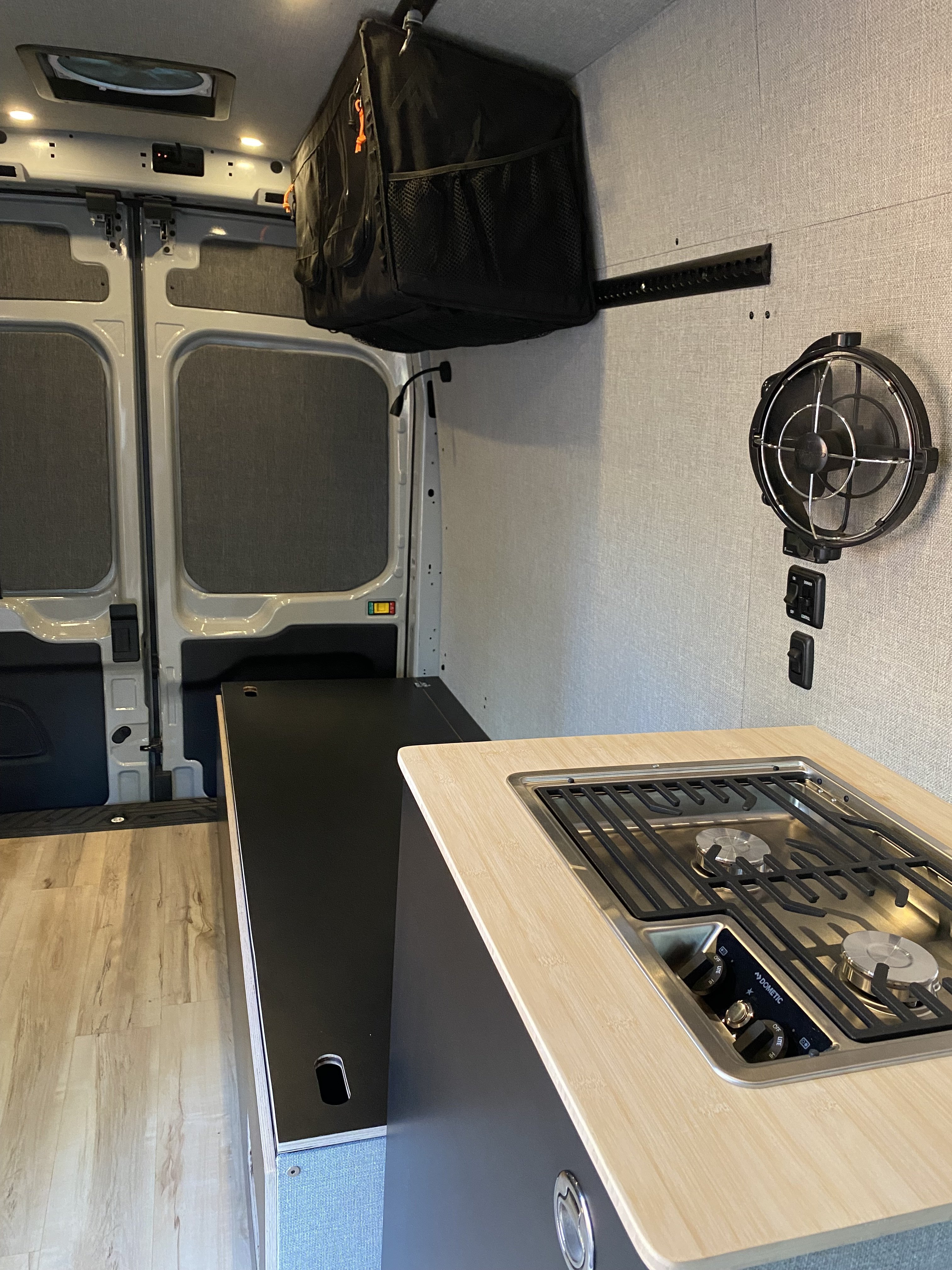

The Galley
We've built vans with sinks, combo sinks/stovetops, and even RV oven/stovetops. Over the years we've found that we don't use/need a sink in our van. We use a cooktop consistently to heat up food and boil water for coffee so that's what's reflected in this build. It's also important that our build tolerate well-below freezing temperatures without running the heater. I don't want to have to run my heater every night 8 months out of the year to keep water lines inside the van from freezing and busting the next time that they're used. We always bring a variety of layers and jackets with us on our trips since we mostly travel up and down California where weather fluctuates considerably. Instead of driving around with clothes hanging off of the l-track on the ceilings and walls, we like to have it all in one place so we built a hanging clothes solution into the galley and it's one of our favorite features. The galley houses the hose from the Espar heater that is routed to the kick plate of the galley. If you've ever been in a van without a toe kick you know how uncomfortable it can be to get close enough to the galley to use the stovetop. Since the heater hose runs through the galley, there is a slight warming effect present to dry out boots/gloves hung from the closet bar. Additionally, the BlueSea fuse panel is housed in the galley where it is safe and easily serviceable if a fuse were to blow (although I've never had a fuse blow in this build and the electrical was completed prior to insulation/walls.)
We use a four gallon RinseKit Pro for our outdoor showers/bike wash/doing dishes. That's more than enough water for our usual trips and we can fill it up anywhere. We don't have to worry about having 20-30 gallons of water sloshing around in our van at all times when all we really need is four gallons of pressurized water that we can take in and out of the van as well please.
The galley is constructed with 15 series 80/20, 1/4" ArrowPly + Marathon wool, 3/4" bamboo + WilsonArt laminate, Blum hardwear, and a stainless steel marine slam latch.
