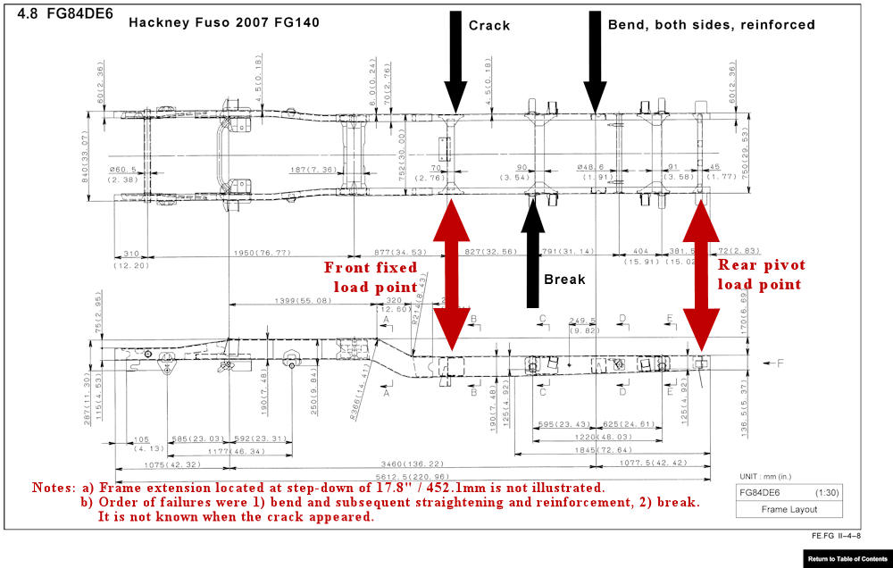

I will start the content portion of the thread by addressing the one known failure of a 3 point pivot system on an FG, which was on our truck. (Please note that Michel has also reported bending in his frame, but I don't know the extent of it and I'll let him, or possibly Ron, address that situation.)
On the Hackney truck, I think the 3 point mounting, frame extensions, and weight may have amplified the stresses in the frame significantly. With this 4 point mounting to distribute the forces, standard frame, and lighter weight, I think I should be good as-is.
I agree with your assessment. Those considering a 3 point design need to make certain that the amount of weight they are proposing to load onto two widely separated points on the FG frame are within its design limits.

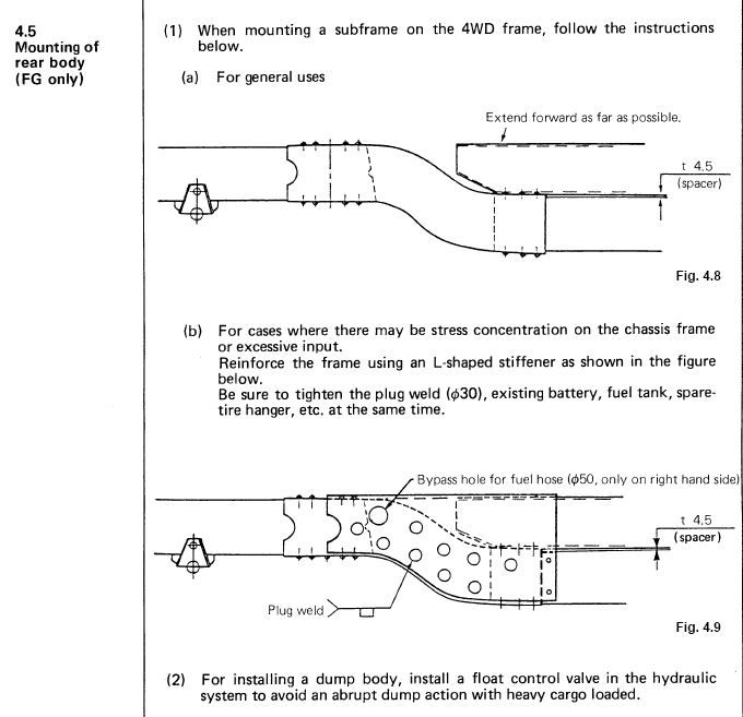

I encourage people to consult the Fuso body builder's manuals available here: http://www.hackneys.com/mitsu/index-chassis-photos.htm
For those interested in reinforcing the frame rails or the step down section, there are detailed instructions in the body builder's manuals. It's a lot easier to do before you build than after... :)
Also, Darrin at RUF has found Fuso North America very helpful with reviews of his sub-frame designs. The Fuso guys have the engineering horsepower to know if what you are proposing is within the design limits of the frame. Believe me, it's better to find out now that what you think will work will actually work. The alternative can be pretty ugly...
Believe me, you do not want to discover that in some remote corner of the planet.
The extremely important issue with the Fuso frame is that like nearly every truck in its class, the frame tapers down to a small cross section aft of the rear axle. Check the section modulus diagram of the stock frame to get an idea of how much weaker that section of the frame is than the area in front of the rear axle - 45.9 cm(3) / 2.8 in(3) vs. 72.3 cm(3) / 4.41(3) - nearly half as strong.
The issue with 3 and 4 point pivot frames is the load point aft of the rear axle. I have no way of knowing what load we were putting on our mounting point back there, but whatever it was, it was too much. Michel reports his FG frame also bent back there with a 3 point pivot design.
You may have no problem for a long time; we didn't for more than a year, and during that time we were on some very challenging roads and tracks at a higher weight than when it bent, cracked and broke. But all it takes is one winching, one unseen-in-time speed bump, one big rock in the dark, or one whatever and you could have a problem.
A four point design will help distribute the weight of your payload over three places on the frame instead of two. IMO, it is a good choice. If you are not going to reinforce it back there, be careful how much payload weight your design can possibly pivot towards the rear.
I plan to convert our payload to a system that distributes the load over the length of the entire frame.
Illustration of our frame failure and 3 point pivot frame load points:
It is my opinion that our payload was too heavy for the stock frame when loaded onto the two points that were so widely seperated. In addition, the rear load point is located on the rear tapered section of the frame, which is significantly weaker than the forward sections of the frame, as illustrated below.
Note that our frame was not reinforced, sleeved or boxed anywhere other than the fully boxed frame extension of 17.8" / 452.1 located at the bottom of the step-down section.
A full discussion and photos of our frame failures, repairs, etc., is located here: http://www.expeditionportal.com/foru...ad.php?t=24225

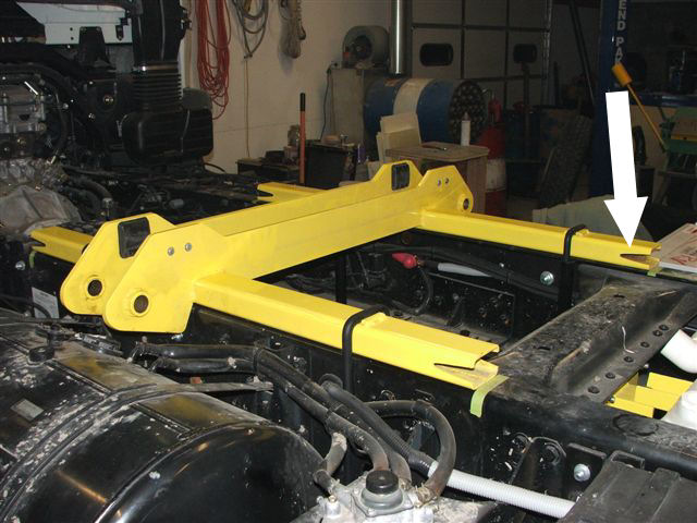

Just finished the rear mounting (this is mostly taken directly from my original Unimog camper project):
The photo makes the rust look kind of bad, it really isn't very deep! I probably need to brush down the trouble spots and repaint.
Can anyone explain why this is the case?
[total and complete speculation] My only guess (note: guess) is that it is related to the stress point of the frame at the rear of the cab. If the payload is "floating" at the front attachment point, it would lessen additional loads into that stress point. [/total and complete speculation]
iandraz,
Note the difference between your pivot point mounting (which looks very similar to ours) and Darrin's.
Darrin spreads the load of his mount longitudinally along the frame with the yellow sections that end with the "fishmouth" cutouts. You could do the same by notching or shortening the flange section on your pivot.

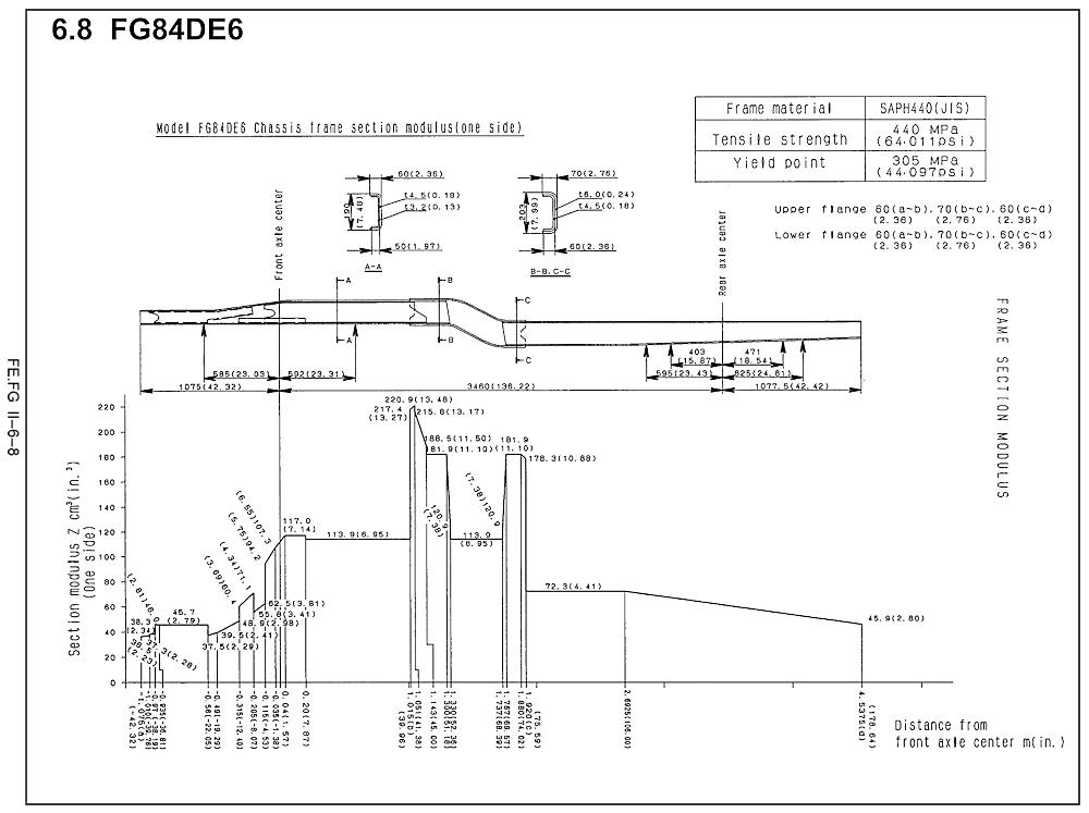

Check the frame section modulus here: http://www.hackneys.com/mitsu/docs/fusoframesectionmodulus.pdf
Note that your rear mount is in an area of the frame that is significantly weaker than where your other mounts will be placed.
By having all the weight carried by the two brackets and the U channel of the pivot mount, you are loading the frame only in that short section; it will be a stress riser in an area of the frame that is already, by design, weaker than the forward parts of the frame rails, as well as very close to the spring shackles.
If you don't implement the type of load distribution rails that Darrin used, consider using extended brackets that would spread the load along the frame web. Be sure and angle them at 45 degrees or less, just like the ends of a frame reinforcement (the angle is to minimize or eliminate stress risers - details in the body builders manuals - page 8 here: http://www.hackneys.com/mitsu/docs/fusoframemodificationinfo.pdf).

The pages related to mounting a body (payload) from the Fuso body builder's docs for the current generation trucks is here:
http://www.hackneys.com/mitsu/docs/fusofgbodymounting.pdf
Note especially the last page regarding mounting on an FG.

Here are some shots of a brand new FG with a dump bed: http://www.hackneys.com/FG/chassis/index.htm
You can compare those shots to these shots of our frame and frame extension: http://www.hackneys.com/mitsu/photos/BEV_buildup/index.htm
I think what you are seeing is the stock step-down section that is joined by a seperate piece of channel.
A step-down reinforcement properly installed for an FG will be plug welded over the step down section. Here's the relevent instructions from the body builders docs.

a) We had to use a rear pivot point on our 3 point frame because we needed to lock the front of the camper to the garage. If we'd used a front pivot the camper would have contacted the garage or we'd have had to raise the camper to clear it.
b) Excellent photos of the legendary mog 4 point system. It's a lot easier to understand with photos. :) I think for those of us who are not engineers, it's like two 3 point pivot frames locked together and mounted back to back on a limited motion teeter-totter. We were unable to use a system of this type due to the camper/garage interference situation. The garage is rigidly attached to the frame. Our 3 point pivot frame is rigidly attached to the frame at the aft wall of the garage. If we put the entire payload on a new subframe and install it on a bigger truck we will probably use a four point system of this type to avoid having another very long distance between the fore and aft load points on the frame.
e) I am in 100% agreement on the superiority of a building full of factory engineers with teraflops of computing power and a test track out back compared to anything we'd do under the shade tree. That is the fundamental reason we bought the FG rather than an aftermarket/3rd party system - it was the only factory 4x4 on the U.S. market.
e) As pointed out, a 3 point pivot frame that is attached on a cross member is not really a 3 point frame since it is distributing the load onto the main frame rails at two points. I had never realized that before. I feel better about myself and our Fuso already... ;)
f) The biggest challenge with our 3 point pivot frame design (and I suspect Michel's) is that the rigid front mounts are a very long ways from the rear pivot mount. That means the entire load of (in our case) the camper, most of the external storage boxes and the pivot frame itself is being applied to two widely separated longitudinal points. To make matters worse, from the frame's standpoint, the rear pivot point is way back there where the frame tapers down and its section modulus is low. I think this is where we over-stressed the frame, by applying forces at the extremes of the dimensions of the frame.
g) I think the FG is a great chassis. The only problems we've had with anything even remotely connected with Mitsubishi Fuso are things we modified or changed.
Doug
