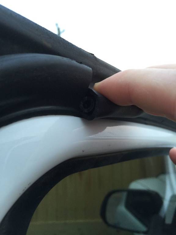

Been looking for a solution as well. Large over on TW sent me this
I went to a hardware store and bought 30' of 1/4" ID thick wall plastic tubing, I think the OD was maybe 7/16" .. it might have been 3/8" but I don't recall exactly. Anyway I cut 2 slits in to each door seal, one horizontal and 1 vertical and cut the tubing to length. I crammed the tubing in to the door seal until it wouldn't go anymore and cut it off, repeat for all 4 doors. I may have to remove this tubing though and go with even thicker wall tubing as the front right door seal is making a very slight peep, but barely noticeable.

Update: I replaced the rubber seals on the front doors and the difference is amazing. The squeaks are gone and the doors shut very snugly. It's like having a brand new truck again! So happy with the results!
