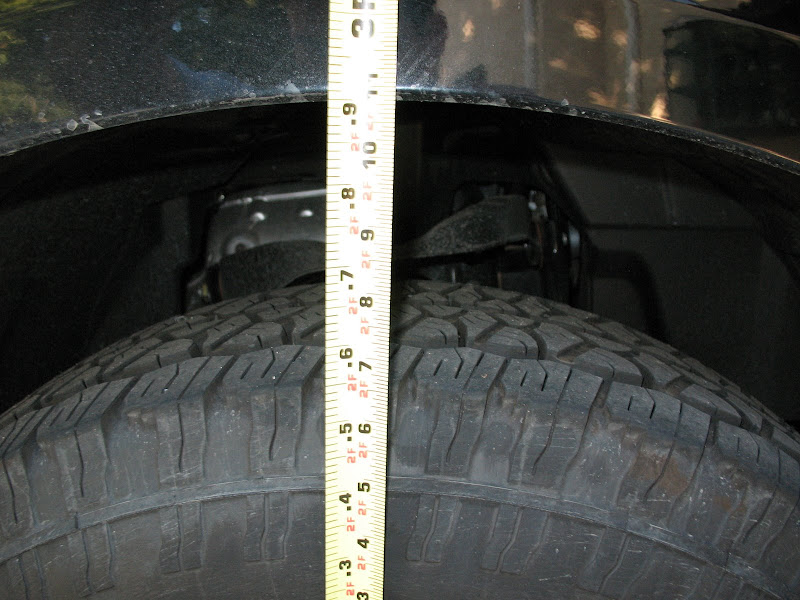

Time for the lift. (Front)
Before.
(Factory spring/strut on top. OME on the bottom)
After.
