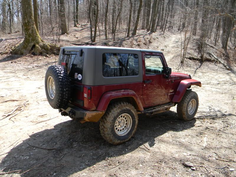

Hilldweller
SE Expedition Society
This is my Sahara with 16x8 Procomp 1059s (4.5" backspacing) and 255/85-16 BFG KM2 tires. They measure a little over 33" and only weigh 54 pounds; wheels are 22 pounds.
With weight on a JK, also consider the brakes; rear brakes wear out fast due to the BLDs and other electronic gizmos.
I've got springs from an Unlimited tow package and a 2.5" Teraflex puck lift with shocks and other stuff. Bumpers, winch, synthetic line.
More bump steer with the older tires; harsher over washboard. The 285/75-16 MTR/kevlars weighed 66 pounds each.
