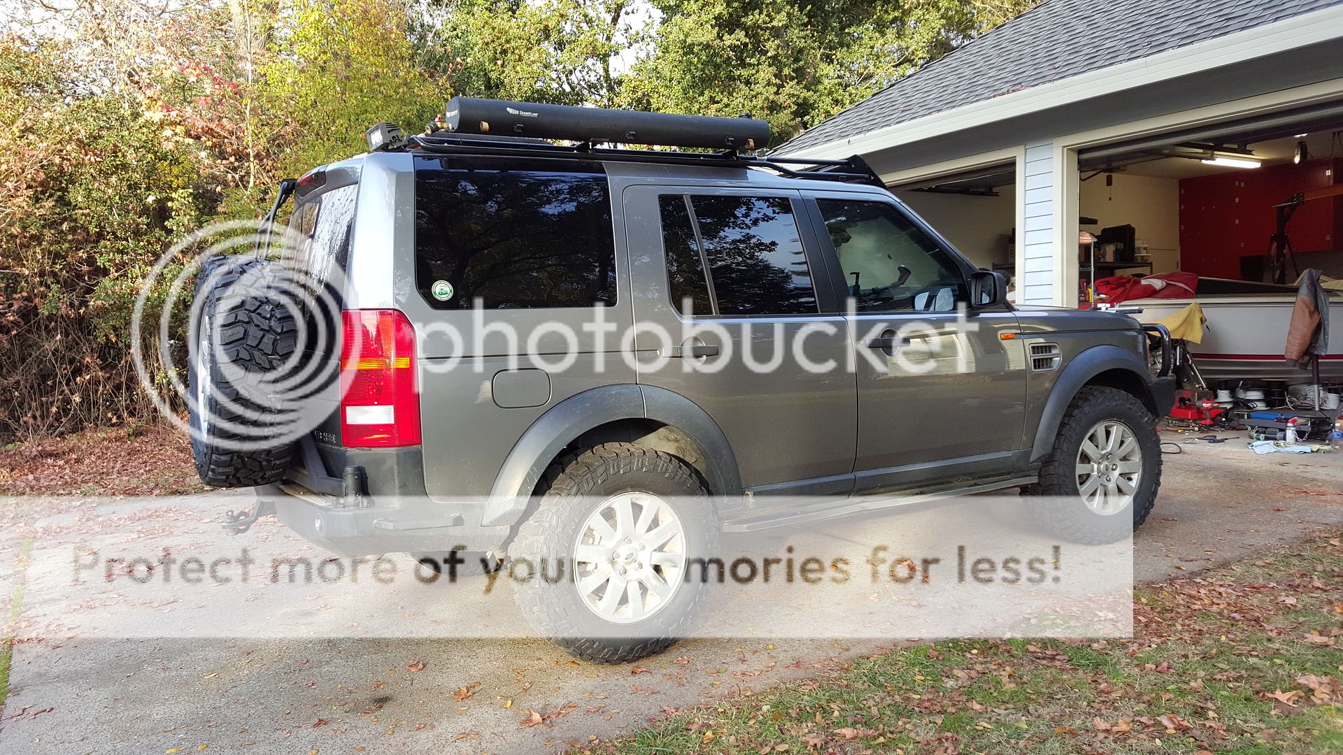

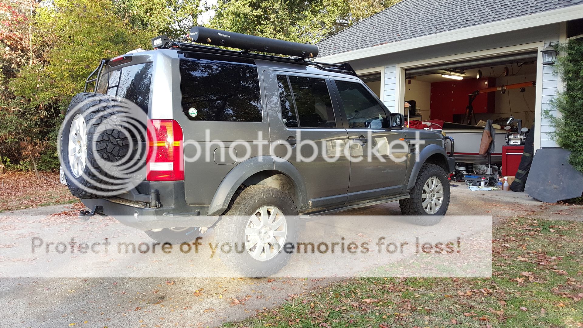

Pictures of the truck as it sits now. This is with the Johnson Rods installed as I haven't gotten around to doing the LLAMS install yet.
Normal height:
Off Road height
