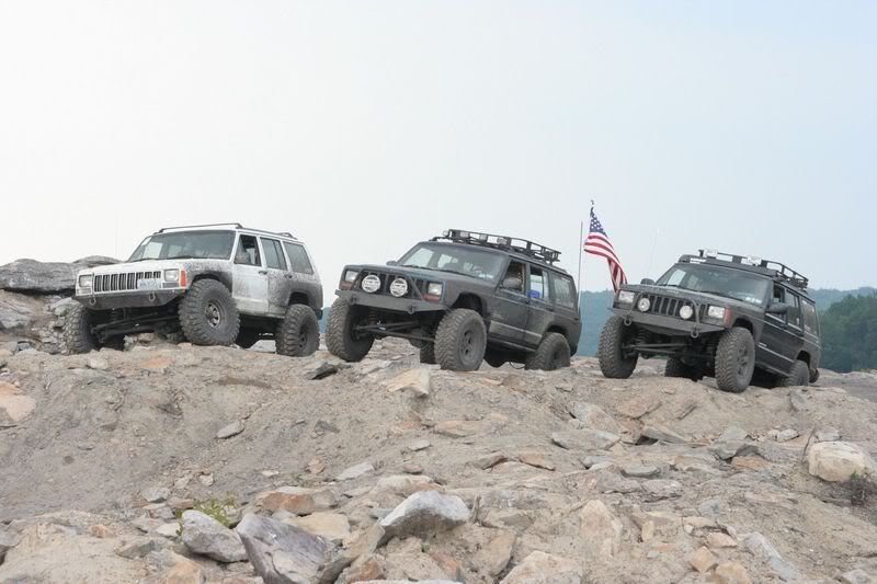

you didnt have to go that crazy, my friend has stuffed 37s under a 2" lift without cutting out the back fenders.

WOW, 37's with a 2" lift!
I'd like to see some pics, any available. I have to assume that he limited the upward articulation and there isn't room in the wheel well for that size of tire.
In my build I wanted to retain the upward wheel articulation as much as possible.
According to JP magazine something doesn't figure with no cutting, 2 inch lift and 37"s. :Wow1:

that JP article is crap.
this is ~2-3" on 37x14" iroks..
same lift on 37" creepys
3"/37s, 4"/35s, 3"/33s
bat
I couldn't even run 32" tires on 4" lift without rubbing until I adjusted my bump stops.
