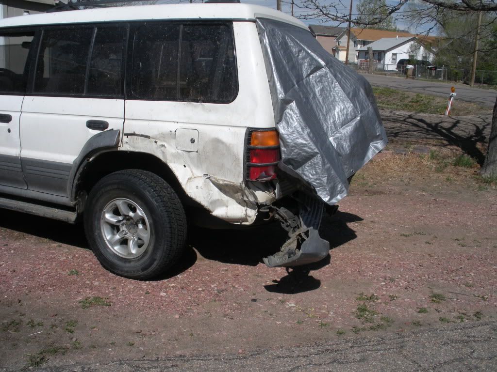

also, with the rear, being that the driver side is all fugly now, i may justcut all i need out and patch it back together. possibly extending the rear links to clear the tub/tire area.
here is the ugly

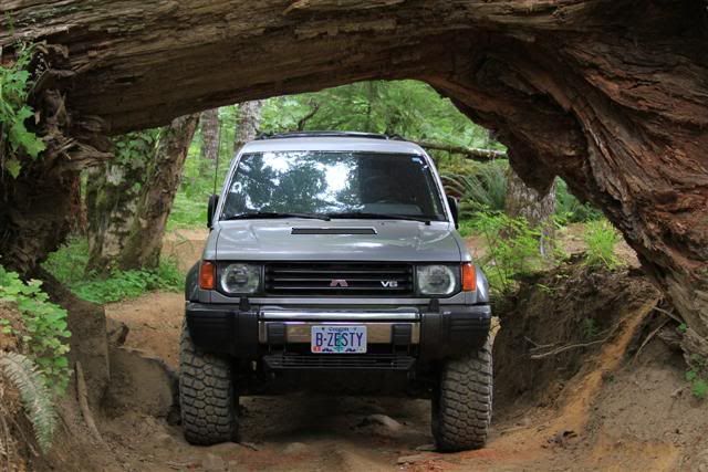

here is the inspiration to my even wanting a montero in the first place. i believe just a 2"BL with 35's.
i think the 35's with no lift, and a proper tire to fender gap, will look **************! plus it will be super stable!
