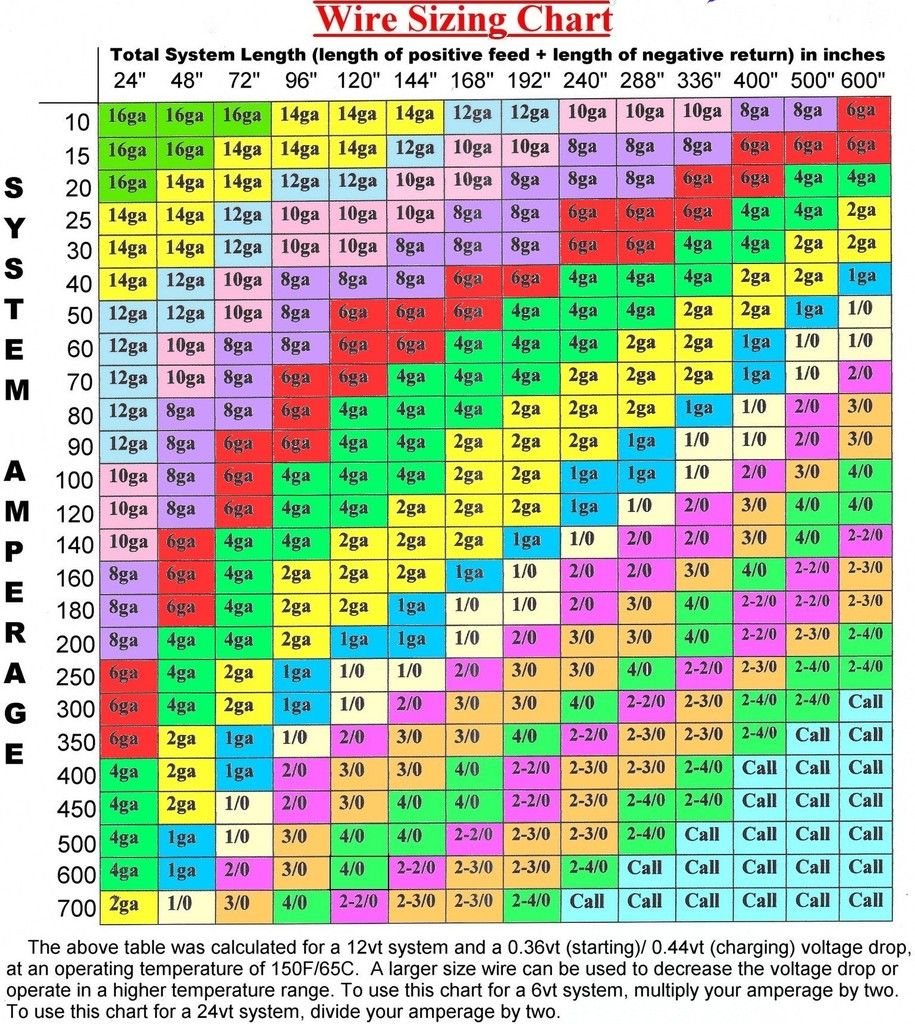

Good afternoon. Does anyone know of a source/supplier for 4-pin quick disconnect connectors (flat trailer connector type) that use wires that are 12 to 14 gauge? Looking at Amazon & ebay the thickest I can find is 18 gauge. I want to use them as a quick disconnect for a pair of 55W HID lights I put on an easily removable cross bar on my Expedition. The length of wire between the relays and the ballasts for the lights would be no more than 6 feet, so I think that 14 gauge may just be heavy enough, but I would feel more comfortable with 12 gauge.

55W is <5amp at 12VDC. x2. At your stated length of 6' you could go as thin as 16ga. 14ga should be more than adequate for the load.
