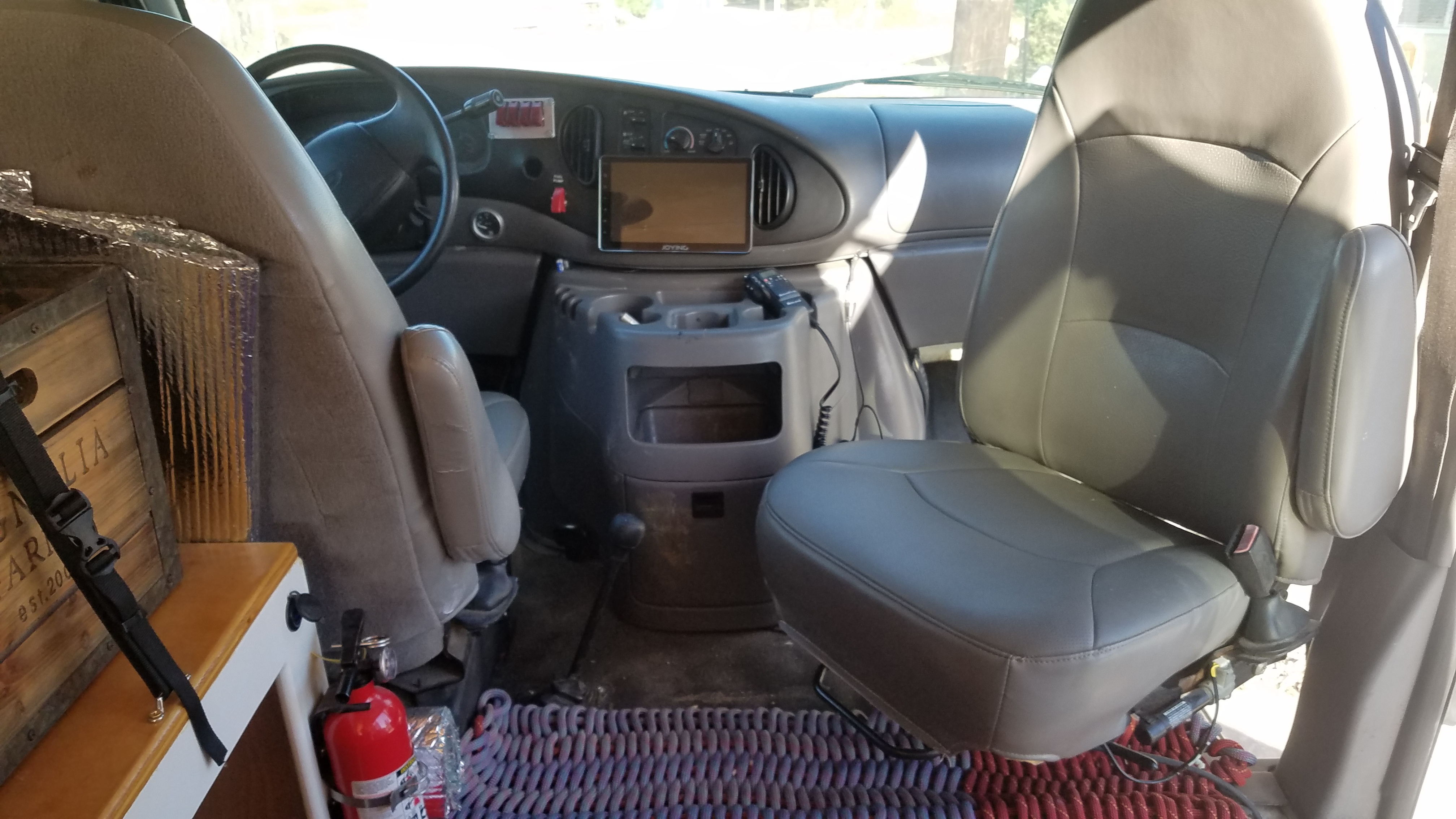

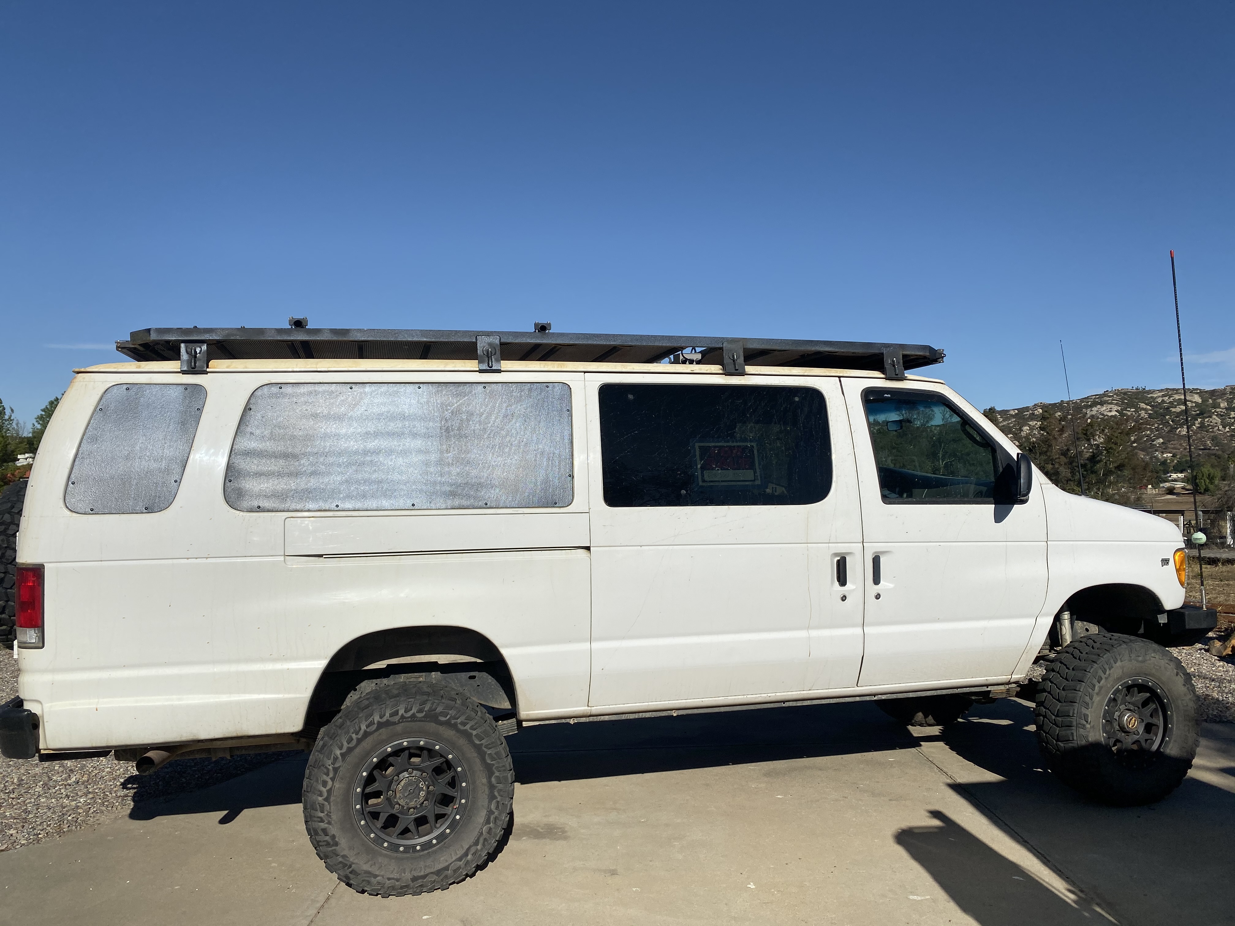

2001 E-350 4 wheel drive van converted to a very comfortable 4x4 adventure camper.
-V10 engine
transmission was rebuilt when the 4x4 output shaft was installed (@114000miles) still under warranty van now has 130k
front axle;
-1999 F-350 4.10 gearing
-new bushings, new warn hubs, new unit bearings, and new brakes
rear axle;
-2005 sterling 10.5 new 4.10 gearing and bearings
-stock posi, new brakes
new drive shafts
tires
-cooper discoverer STT pro 315-70R17
-90% tread
4x4 kit buy "U-joint Offroad"
fox 2.0 shocks
custom leaf springs by "Atlas spring"
2nd fuel tank installed, 60gal(pump to stock tank on the fly)Total vehicle fuel capacity 84 gal
15.5 superwinch (synthetic line) in custom offroad bumper
rear "Aluminess" tire gate

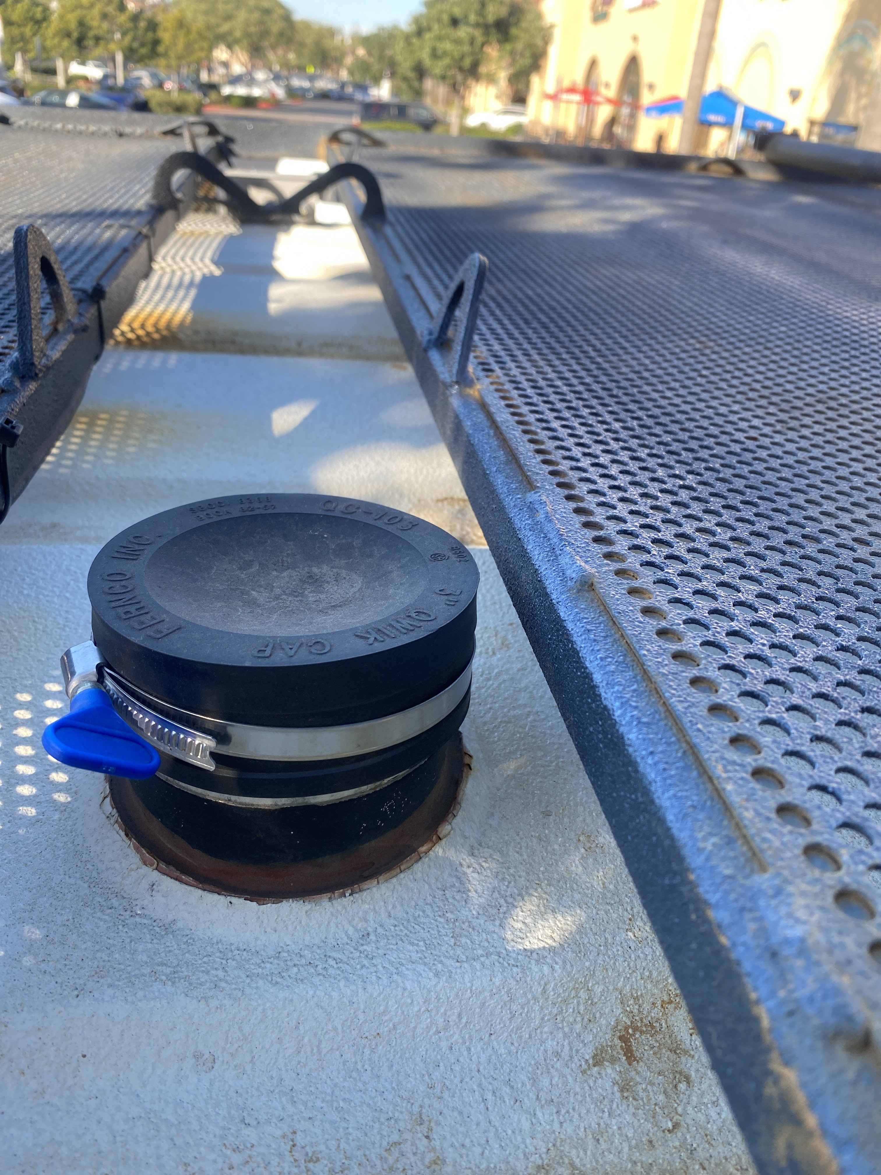

custom roof rack with 100w solar panel
front light bar 30k lumens
rear light bar 16k lumens
all rear windows were replaced with 1/8" aluminum and bed lined.
class V trailer hitch

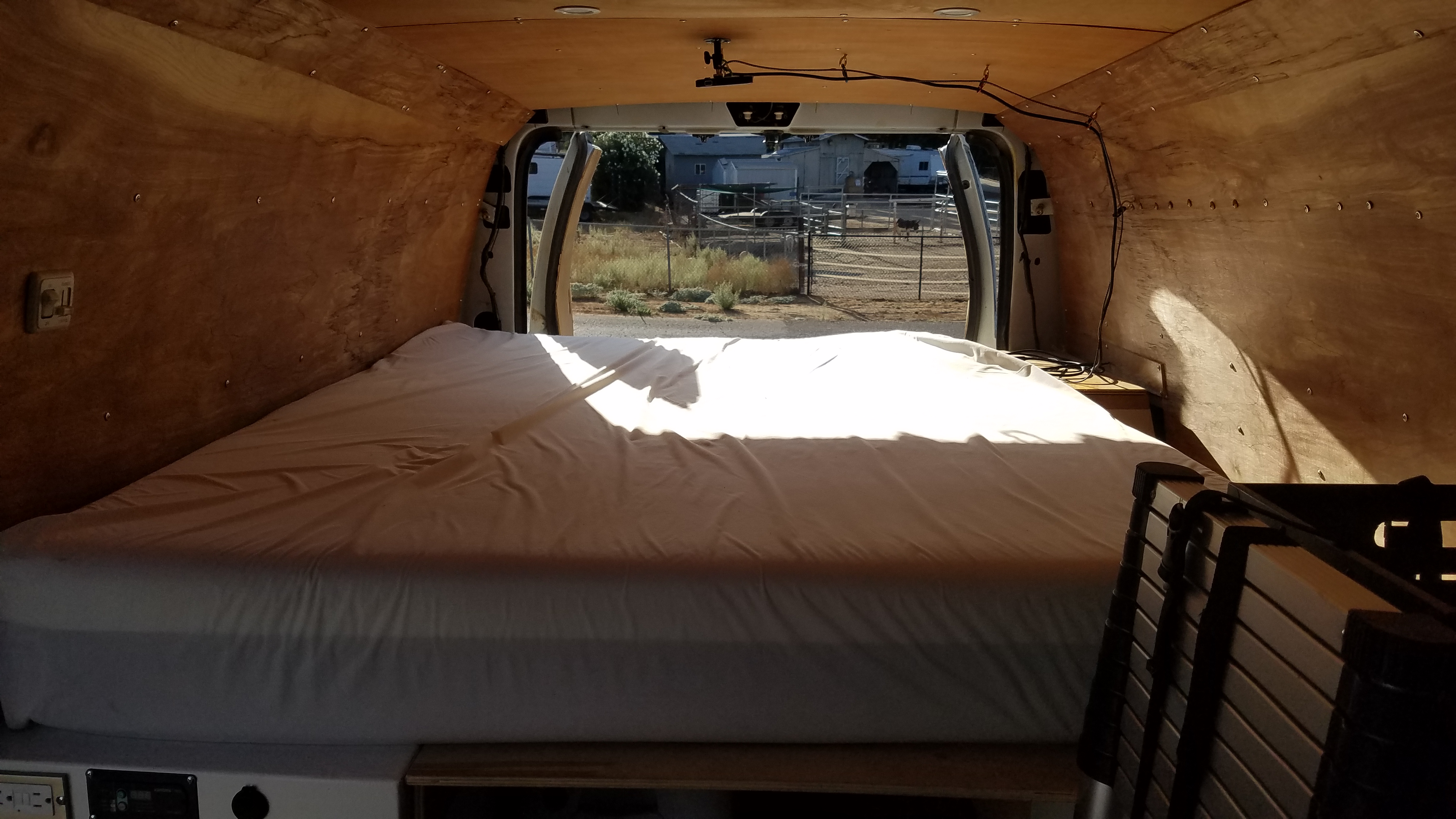

INSIDE,
completely built from Birch plywood bolted to the stock seat mounting systems

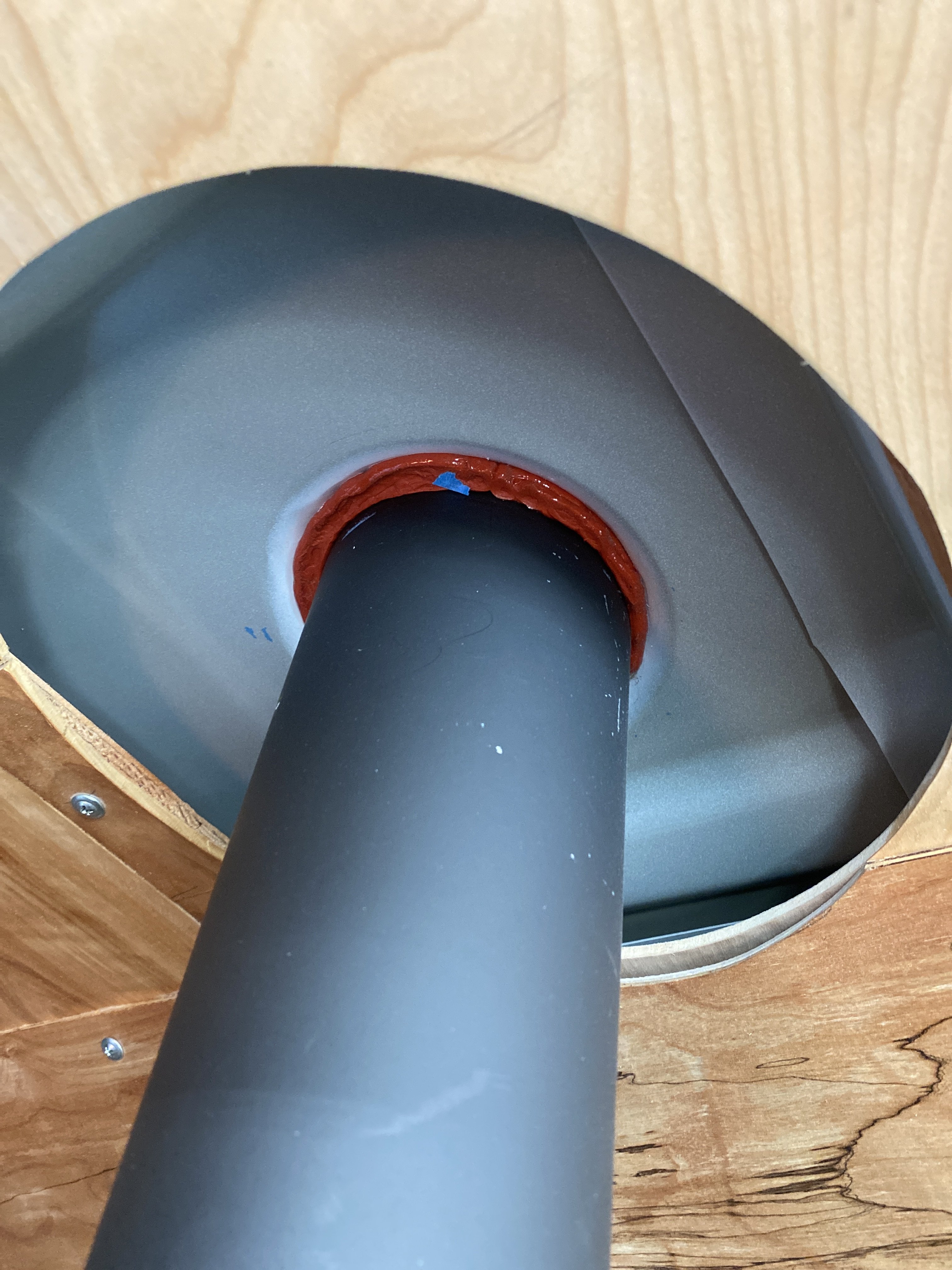

storage everywhere, temperpedic mattress, standard tools and recovery gear included, 2 sets of snow chains also included, cubic mini wood burning stove to keep you warm on those cold nights, passenger seat swivels to face rear, 10.1" joying stereo.

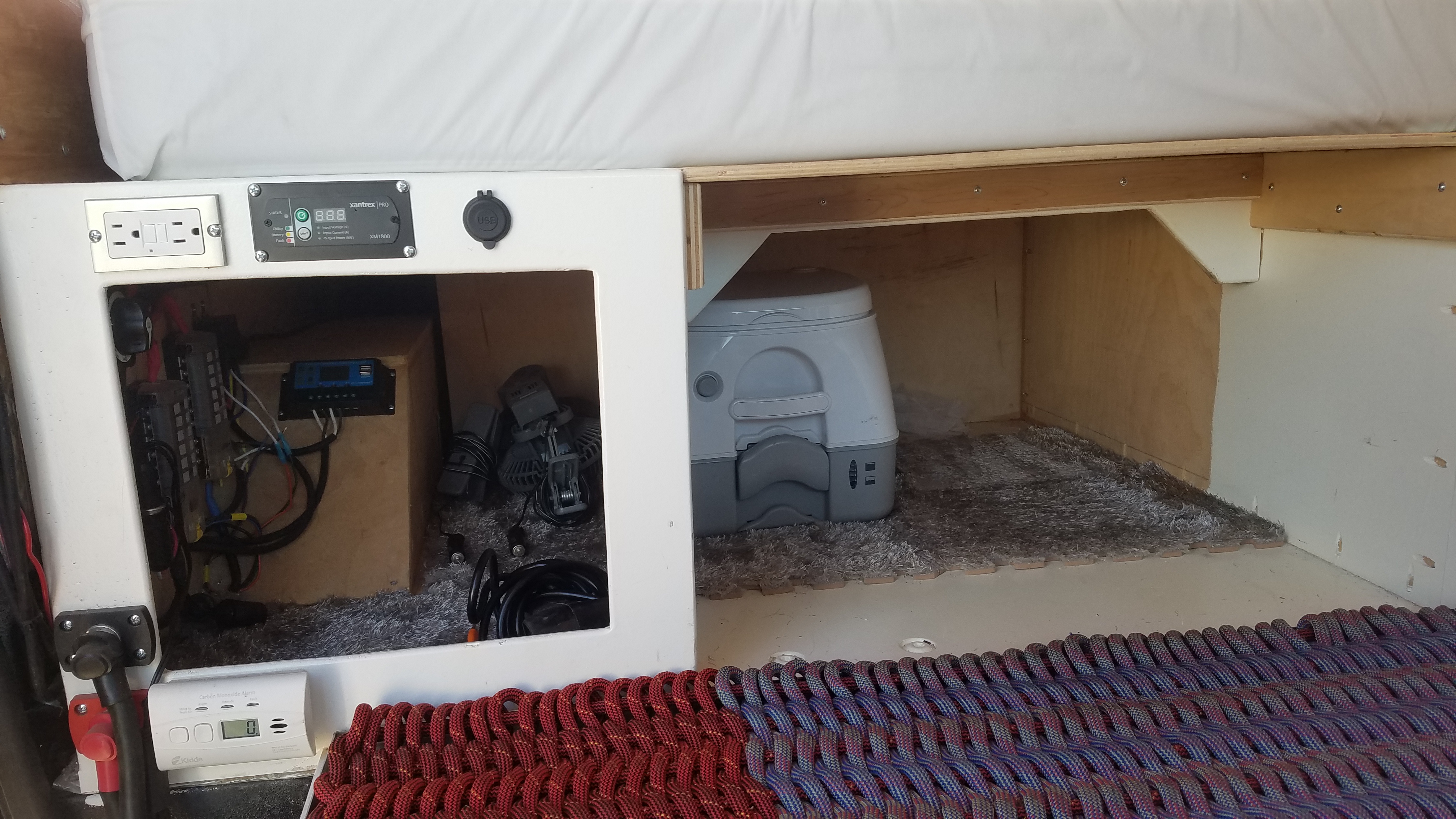

electrical
-1x 100watt solar panel
-3 deep cycle rv batteries
-1800 watt clean power inverter
-solar charger directly to battery bank
-isolation switch connected to vehicle battery in case you leave the head lights on.(no jumper cables needed)
