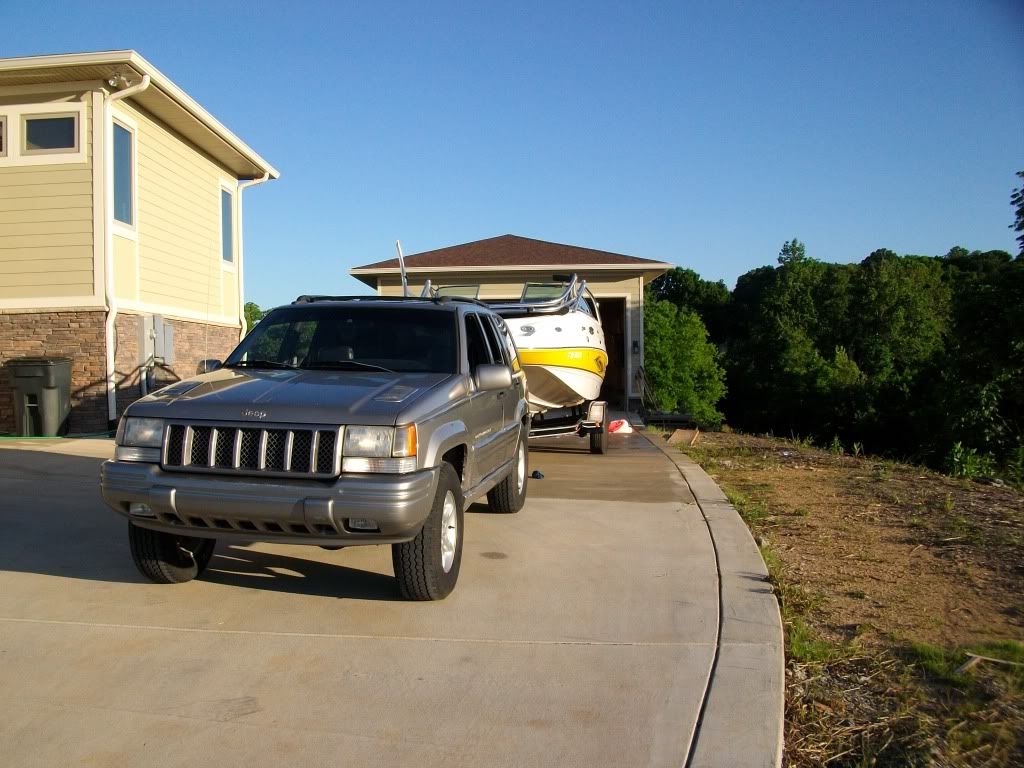

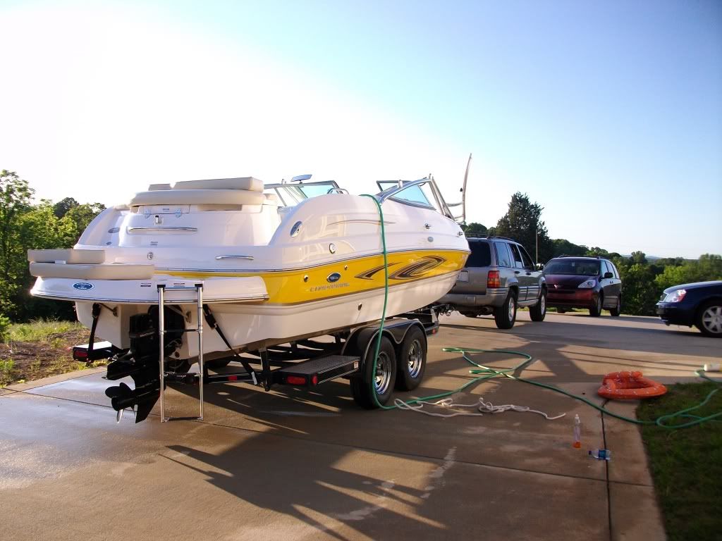

My 5.9L grand has 3:73's and a 4 speed OD Tranny with the part-time 231 HD Tereflex case. The power is fantastic. I also have a ford 7.3L diesel. The Jeep tows my 6000lb boat out of our Marina just as well as the Ford. Very steap long up-hill climb out.
