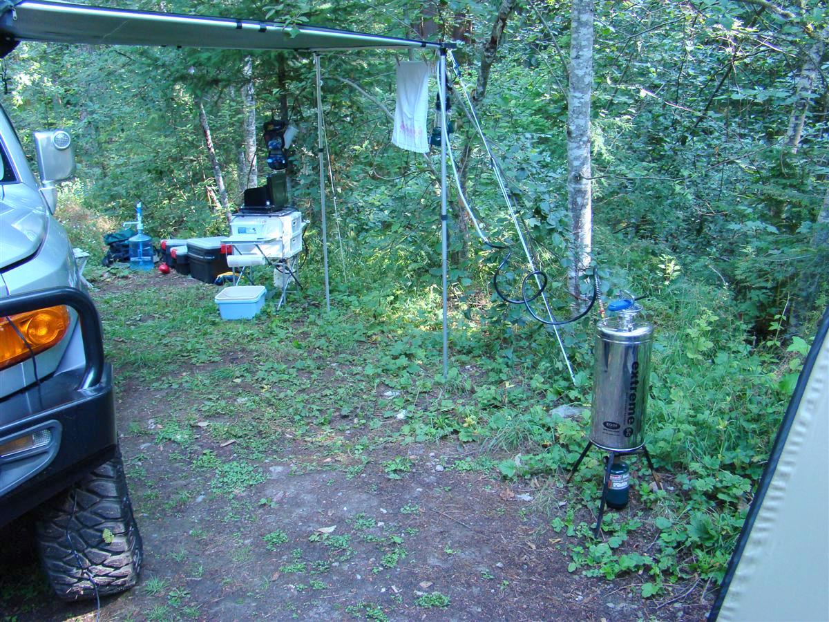

Zodi Hotman Extreme here.
Have had it for three seasons, and no complaints.
It has a strong burner on it, and I heat the water while I am doing other chores in camp.
When it is ready, I take it off of the burner and set the can directly on the ground inside of my Outback shower/crapper enclosure.
You can insert the hand pump then or outside, but never ever have the pump in when heating the water up.
The shower comes with a small crappy shower head though, I suggest discarding it and modifying the unit with a sink sprayer like I did.
You have more control over the water this way, and also better pressure.
When the pressure gets low, just pump it up some more, no sweat.
