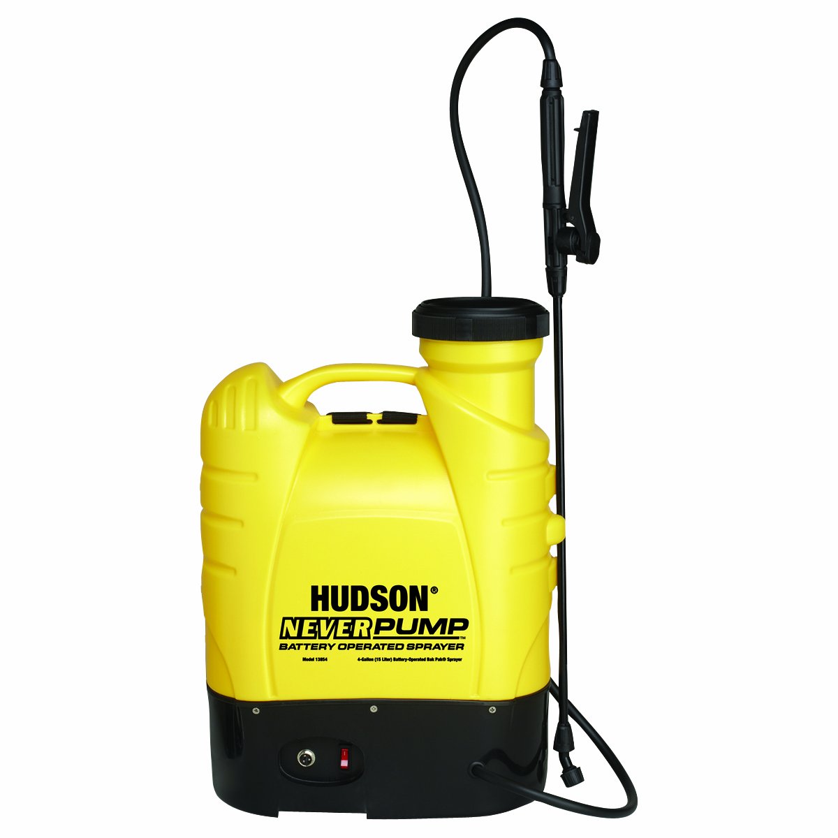

Maybe I oversimplified it, but as Theksmith pointed out about using a sprayer, I picked up a heavy-duty, two-gallon garden sprayer at Lowe's, replaced the hose with food-grade tubing and stuck a nozzle from an old solar shower on the end.
Ten feet of hose, pressurized, gave us enough volume and pressure for a long shower (by camp standards) and for kitchen duty. Under $35.
