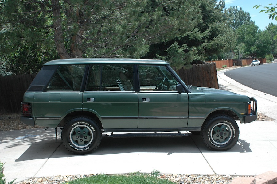

FIRST:::: I am really looking for an expedition ready vehicle... yes the lone wolf , camel trophy 110, or even the DEA h1 would be nice , I'm not there yet but I am at around 10k for a great used rig that has most or all of the stuff I want to put in mine already.... rtt or sleeping system/ power inverters/supplies/systems, with air / self recovery equip./ storage systems,racks,ladders,swing aways, fuel/water aux. / i'm more on the self sufficiency/comfort end
LONG STORY SHORT-
I live in Houston... I flew to Denver to buy RRC from someone who had it listed on ebay and craigslist... bought truck, ran great for the day... decided to drive back to houston.. anyway , engine overheated at 3 am... blew radiator hose , found out there was hardly any oil in it , burnt coolant everywhere...... end of story , had 3 hour tow ride to colorado springs airport and my truck is still in colorado at a rover shop. missed flight.. had to stay over.. blah blah now i'm back home and the shop is saying new engine. it had 170 on it... 4.2

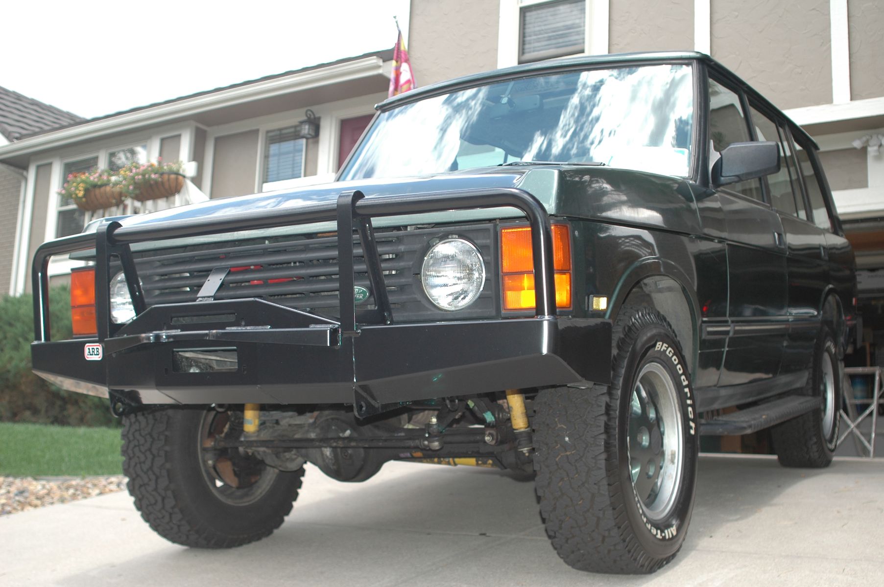

so this is where I'm at.from an engine swap and build it yourself/keep it / turn it profit point of view: you get to choose what engine you want in it and poof it's ready to go. or buy it for the parts? truck is very clean, in and out. NO RUST, not even on the BRAND NEW TAILGATE AND GLASS(600) or around the NEW WINDSHIELD(600), or on the BRAND NEW ARB WINCH BUMPER(900) has optima red top battery, has space for second battery also... has the coil spring conversion with 2" lift done already.
very new bfg's all around... newer brakes, new starter, alternator, headliner

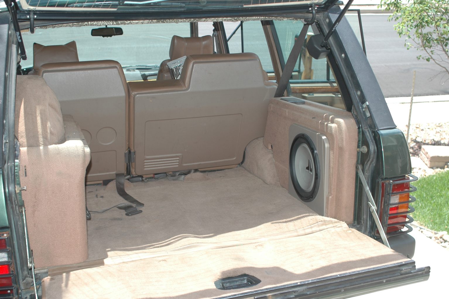

very nice stereo with kenwood head with usb /ipod input, JL audio sub and amp in FACTORY position. Factory rover all weather mats front and back, very nice... everything electronic WORKS , seats WORK, windows WORK, even the side window tilt
A/C blows cold , heater goes hot
The shop I dropped it at happened to be the one he used for service... they said they have records of 6 g's of work just from them.. and he said you used jc rovers also. no idea to verify that though.
I have more pictures I can email thanks
