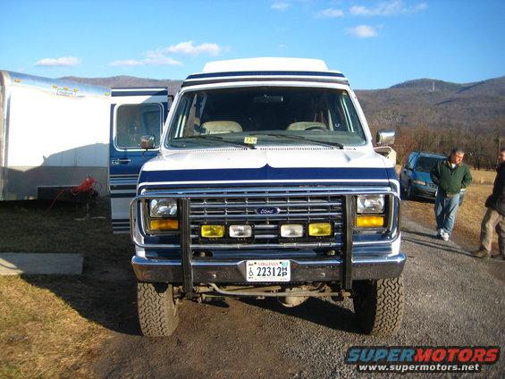

I have poured more hours than I can count into my 81 Quigley (doesn't really look like that much yet but it was coming along) And all of a sudden I run across a deal I could not refuse for another E-350.
It took over a month just to get a chanceto view the van ( super long story involving a super shady mechanic)
Well long story short, I had to have it.
Here's a few pics sent to me from the previous owner.
Specs
1988 E-350
7.3 Turboed by Banks
Banks exhaust
C-6
Not sure on Tcase yet
Dana 44 front
Dana?? rear
Quigley 4x4
Stay tuned for the build up. Interior is fully stripped for a blank canvas.

Looks like I may have solved the tranny issue. Did some digging around and found out that there is more than one kind of modulator valve available for the C6. The color of the stripe aound it tells the diffrence. The trans had a new modulator valve on it with a green stripe. When checked at the parts house, they showed it called for a the valve with a black stripe.They happened to have one in stock so I picked it up. Swapped it in last night , made a huge diffrence ! Seems to be shifting normally now .
partsflyin
Cool rig! (and nice avatar!)
- Andy
LOL! Thanks !!
Just a little bit of and update. Have been driving the van everyday for a week now.
All I can say is Wow!! I love it !!
The $11 modulator valve seems to have cured the "smoked" trans. The second issue I had to contend with was a "bad" injection pump. Diagnosed by the crooked ******** mechanic who had the van on his lot.
Asked the owner what the original problem was , requiring him to take to the mechanic. "Hard starts" were the only actual problem.
So I started by installing a new set of glow plugs. upon istallation I found one plug to have a bad wire wire.
While in the process of installing the glow plugs I also found a badly dry rotted fuel return line. Seemed as if it was allowing air back into the fuel system.
So I am happy to report the van is starting up and running great !! Total investment in
van, glow plugs, oil, filters right about $2500.Also need to add that I found a Jasper engines tag on the 7.3 for 6/03.
Needless to say I am unbelievably stoked !!

Thanks! The interior is full stripped at the moment but I will be getting some pics soon, as I am stoked about the way the floor was reworked. Evidently the van started life as a handicapped wheelchair van. It actually has a 2" body lift on it. This allowed for the floor directly behind the front seats to be "dropped" four inches. It is dropped 4" all the way back to directly in front of the rear wheel wells. With the raised roof and dropped floor , I can stand fully upright in this area of the van.:wings:
