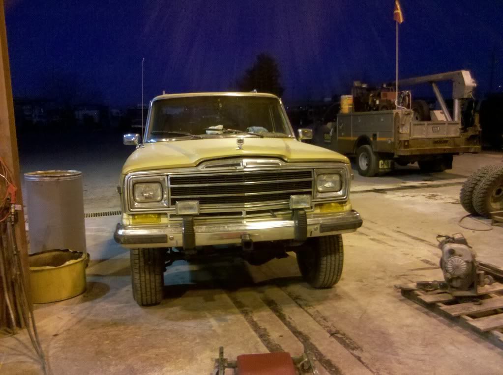

Hello and welcome to the forum. We are currently building an 87' SJ to be our family exploration rig. Here are some pics of what we are working with.
sorry don't want to take over your thread, figured you can get some ideas and motivation from the pics.

great looking truck. I love your front reciver hitch, that is somthing i would like to do also. hot much lift does your truck have?
dirty Bakers
Conservative
I performed the spring over front, shackle flip rear, from bjs off road. I also installed the crossover steering (required) from bjs. Works like a dream and rides like stock.
