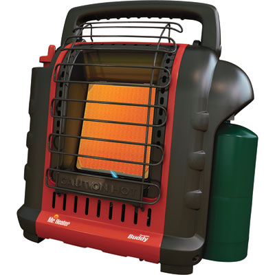

I have one of the medium sized mr. Buddy 's. I have yet to really try it. Just thonking a fan makes it much more efficient. Any more pics of the m416 there? That's the same tent lift system I'm going for.

If that's the propane heater you're going to use you should stop at http://stricklandpropane.net/ and talk to Hank Hill first. I think that Hank will tell you that heater is not a catalytic so it gives off carbon monoxide. Hank is the expert on propane and propane accessories and I know he'll add more cautions.
This is the catalytic version which doesn't give off CO but does use up oxygen so you still need to be careful of not using up too much O2 and getting sick or dieing.

Safety should always be a first priority, and I don't want to try to talk others into doing something they're not comfortable doing. The "Buddy" heaters you mention are "OK", but I would rather have one larger propane tank instead of having to deal with the smaller bottles. I wonder if you could hook up a larger propane tank to them. I like the idea of having a catalytic converter on the heater though, just to be extra safe.
