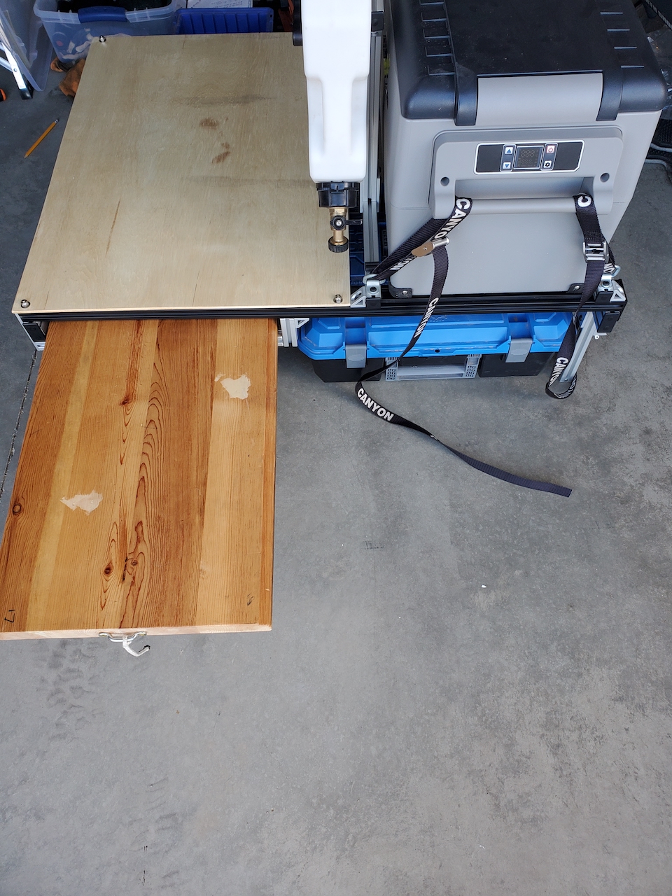

Have a recently completed camp kitchen setup from some extra alloy extrusion I had. Made due with what was on hand and only ordered some additional brackets. Designed for the back of a 5th Gen 4runner (No 3rd Row). Its ready to go just needs some turnbuckles. Designed to work with the backseats in their normal upright position, so you can leave it in all the time, ust add fridge, rotopax, etc. and ready to roll.
Includes the 2 Gallon Rotopax/Custom Spigot setup. This Rotopax has a drilled air bleed valve at the top, and a rain barrel spigot mounted in lieu of the yellow tube. This allows the Rotopax to be mounted in place and fill bottles, pots, etc. with just the turn of the lever. Had a custom washer machined in order to match everything correctly. The Spigot setup can be swapped between Rotopax's so you could have an additional 2 Gal Rotopax and just swap them across when needed.
It's very strong, I stood on it at 180lb and it didn't flinch.
Easy to add accessories onto it, I have a bag of additional bolts, tnuts, corners brackets, track studs, and some short extrusion sections. This is all standard 10 Series alloy extrusion so can find other mounts, parts, etc. online if needed.
You could mount a fridge slide pretty easily, I just don't open the fridge that often to justify it. This is setup for a 30L fridge currently.
Built just tall enough to fit 2 full size DECKED boxes on the right hand side, placed two deep.

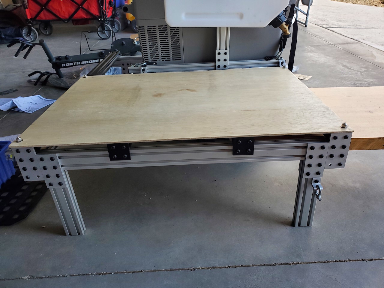

Slide out table/work area is from an old work bench top I found at Habitat for Humanity, cut down and two coats of poly. Its on a track guide extrusion piece hidden on the bottom, it locks at the extension shown and is retained there.
The 2 center black "crossbars" are able to be adjusted independently from anything else, currently I have the 3rd crossbar at the back corner of the fridge, but you could adjust those however you need.
This material isn't cheap, so looking for $450/obo with the Rotopax/Spigot setup and 2 DECKED Boxes. Fridge not included.
Dimensions: 41" Wide x 32" Deep
Fridge Area Dimensions: 14" Wide x 32" Deep
The mounts are on slotted brackets and can be placed anywhere, if the dimensions work this could fit a variety of vehicles or be used as a rear half system in a truck.
