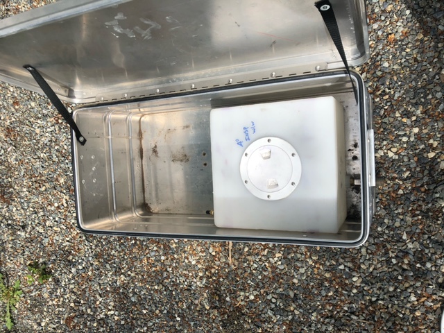

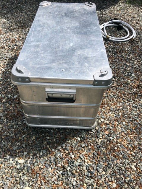

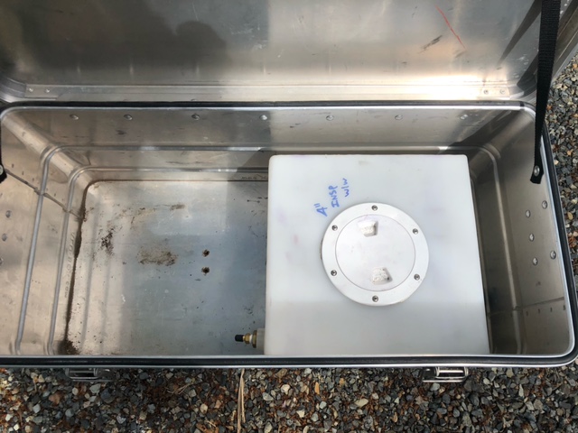

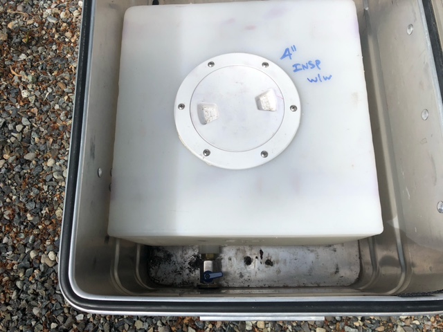

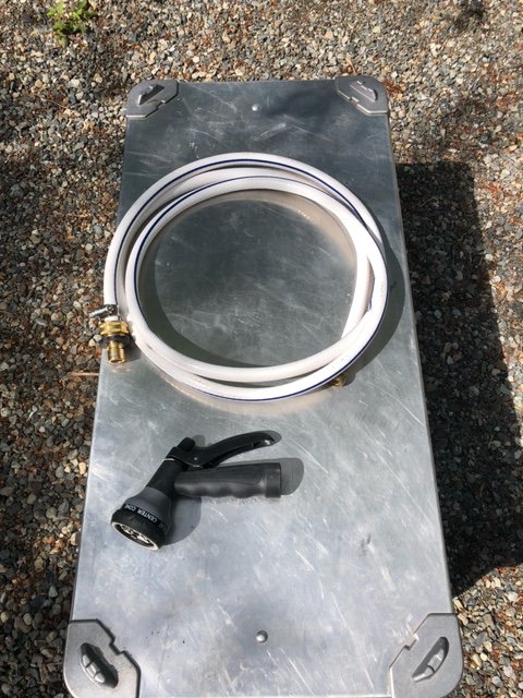

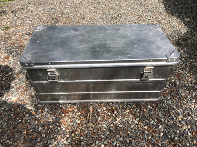

Built in custom 5 gal water tank.
This was mounted on a Rhino Rack rack. Allowed half the space for storage but the other half holds 5 gal of water. Shut off value inside the box and I had a quick disconnect on the outside. Just plug the hose in and you have water. The water tank has a Schrader value to pressurize the tank but honestly I used it once and found gravity to be better. The tank has a 4" access for water filling and tank cleaning. No messing about trying to fit a hose in a 1" opening. I found on the pressurizing the access lid needs to be really tight for the seal to, well seal the air in. It makes removing a pain. Gravity has always provided plenty of pressure.
