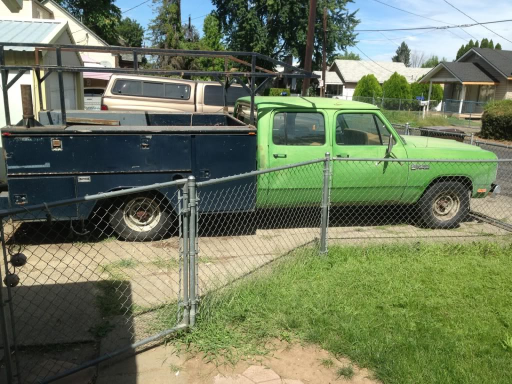

Some brainstorming and general searching I found a good truck to start with. As long as looks aren't necessity. Lol

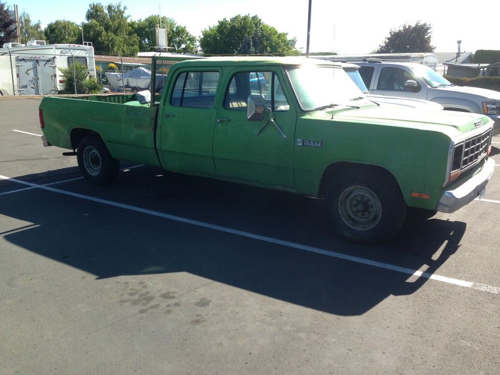

85 Dodge D350 srw crewcab
Got the truck street worthy. Drove it around started the planning process.
Gotta be 4wd. Since its a looong truck I believe I will have to run a tad higher lift to prevent getting high centered on everything. So 6-8" lift. 37" tires.

All good ideas. Well wife came up with a really good idea. Then proceeded to find one for sale. A utility bed. Perfect. Honestly I like the utility bed trailers everyone e builds on here. Her idea is perfect. Get one for the crew. That way no separate trailer can still tow another 4wd behind us to play. It's an 8' foot bed so a matching box will have plenty of room for things.
So as I said she found one. My idea was a srw 8' bed. She found one close to that. However it has a roof rack. No meed to put one on the truck cab. And it's for a drw.

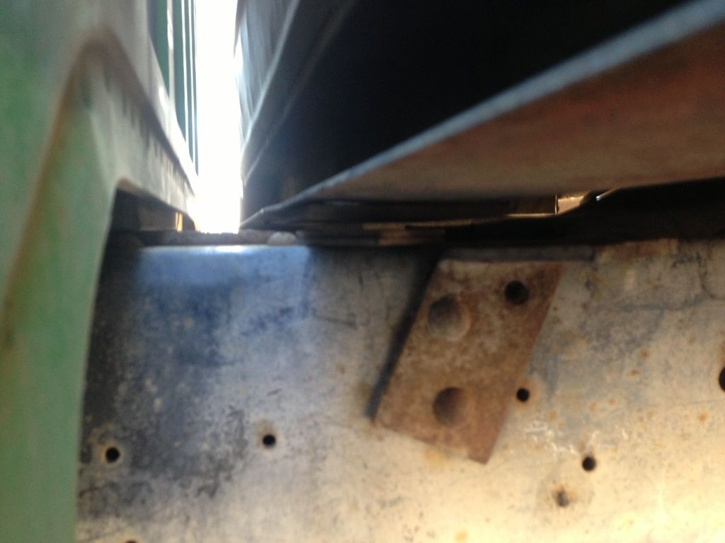

Got the shock mount out. dropped the utility bed about 1/2" sitting on the frame got is lined up mostly. However if the measuring tape is even it looks off by the cab. IF the appearance is good the measurements is off by 1"

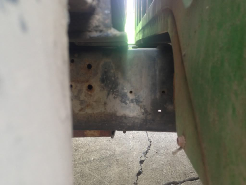

Well it looks like an interesting project you have going there. Is that a cracked frame I see in one of your pics between the cab and the bed? You can make a semi floating arangement for the new rear bed that incorporates a steel flat bar on the side of the frame and some bolt/spring assembly to keep it tied down. Something like what Carlyle used in his monster Dodge truck and Alaskan camper set-up. I have also seen hardwood shims used inbetween the bed and the frame. Just some options you might want to consider. Good luck on your build and keep us updated with lots of pics. Cheers, Chilli...:)

Cracked frame? Where?

98dango
At first glance I also thought I saw a crack hut it looks to be the concrete.

I think the crack Chilli refers to is in the pic right above the concrete crack and to the left of the 1/4" (?) hole. It might just be a shadow from a flake of rust or? Should be a fun/interesting project!

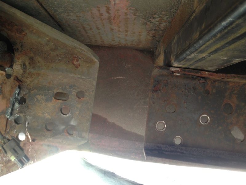

Couldn't get the box to line up. Got the side to side measurements but its not square with the rear cab wall. Found a possible reason. Oh took another pic of the frame as well. No crack. Whew!

You could make your life much simpler by getting an 8' box and rid yourself of the 9' one pictured. The Dodge frame is designed to flex, acting like a bridge. I've read elsewhere that the CC have problems with cracked body mounts, such as pictured.
