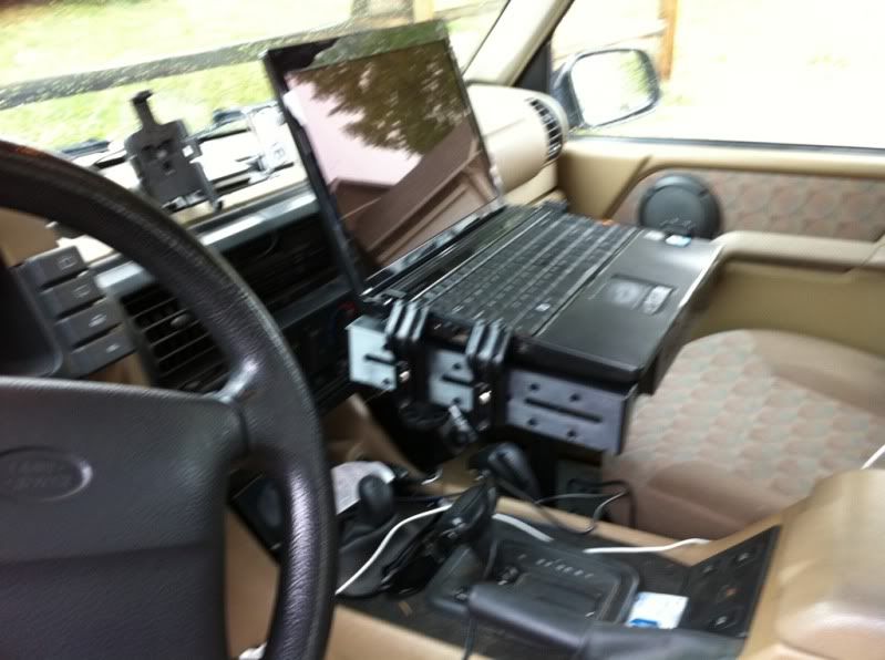

I have been planning more and more for overlanding my Disco. I took my first step in making sure I will not get lost!:)
Ram Mount
Bluetooth dongle
GSat bluetooth GPS reciever
Overland Navigator software
200w inverter and 12v socket expansion for power!

Silly Tom. Compass on software for laptop, motion-x gps on iPhone 4, guide books and paper maps above windshield in map storage.
Antichrist
How well do they work if the electronics fail? HD crash, screen death, iPhone dropped or drowned? Or just plain dead batteries?
Not knocking using a laptop or GPS, I've been using mapping software on a laptop and GPS's for about 10 years, but I also know things go wrong.
Howski
Well-known member
the laptop seems extremely cumbersome in that spot. i don't think they have any more room in that area than a D2 and it is pretty tight in that area if i even have a decent sized drink in one of the cup holders
ColoDisco
Well I did not think I would be spending a bunch of time defending why I did this but more rather inspiring more ideas. Eventually I want to add either a toughbook or a tablet in this area. The RAM mount is capable of folding completely vertical so it will just be the screen showing rather than have the traditional laptop position as you see now.
You are not thinking outside the convenience box FSU. Get the cup holders that go on the side of the center console.
The reason it is sitting there is there is still a airbag on the passenger side of the vehicle. I intend to remove the airbag and install the handle option if I can find one.
It does not block my view at all where it sits.
Also I took this offroad this past Sunday and it was not in the way at all. In fact it was nice having a 13" nav display even though microsoft S&T 2011 did not recognize I was on a FSR.
