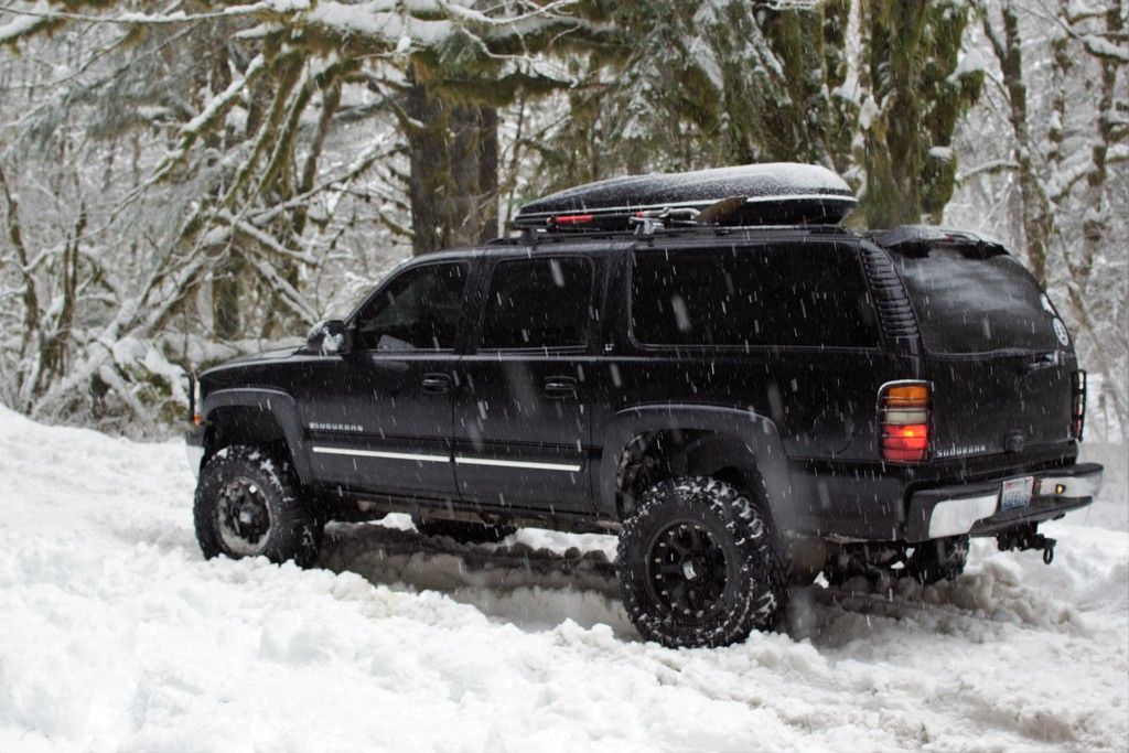

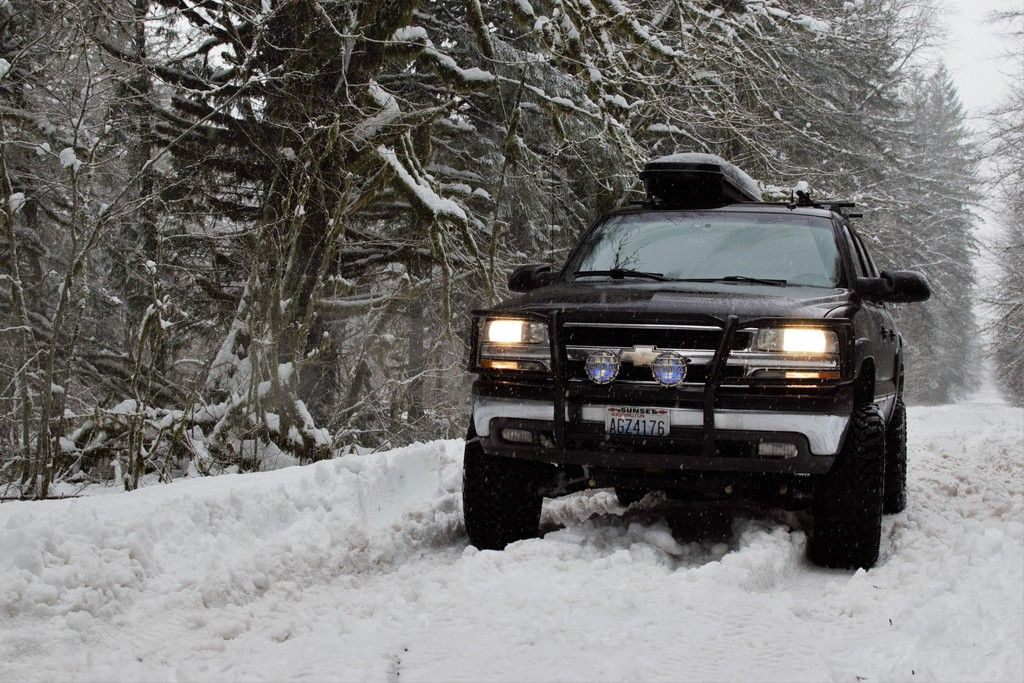

She did well for the heavy tank she is. Helped pull an F250 out too! In the untouched areas, it was about 18" deep, and for the most part, had no issues getting around.

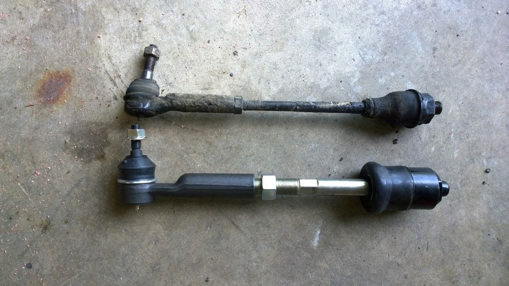

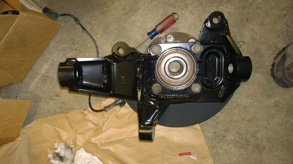

Now this is a question that I can answer with some authority. Some back story, I come from the 'tuning' scene (think Fast & Furious, without the underglow and living my life 10 seconds at a time). I was into imports for years, and my last couple cars were both Mitsubishi Evolutions (last of a true rally heritage from the M). I spent lots of money and lots of time, and lots more money, modifying those cars. I learned that when it comes to suspension, the term you get what you pay for really has meaning. And if you change a vehicle too much, or compromise its fun factor in any way, you wont drive it or want to any more.
All that being said, a good friend of mine had a GMT900 Silverado with an RCD 6" lift that rode like ****. Actually, it made **** feel like riding in a Caddy. I did not want that. I did lots of reading, and lots of looking around, and the only thing that came up time and again for suspension companies for Chev was Cognito Motorsports. I read mostly only good things about them (I am not affiliated in any way, and only speak of my experience here). I looked into their stuff, and liked what I saw design and quality wise, so I called them, and ordered their 4-6 inch non torsion bar drop kit, with the upgraded UCA with bolt in ball joints, their steering kit, with their steering tie rods, and Fox 2.0 shocks. All said and done, it was ~3400 shipped to my door. A lot considering the magazine price for some of the other kits was in the range of 1500. I got home from work and checked out the pallet that showed up, and I was extremely impressed with just the packaging right off. Very nicely wrapped, everything was in boxes with formed foam padding. I started pulling it apart, and noticed that the instructions were very well written and seemed to explain the steps well. Things I liked about it: the welds looked very very good, the machine work was excellent, and the powdercoating appeared durable. I also liked that they redesigned the entire knuckle, making it taller. Their kit reuses the UCA chassis mount, and just uses a new cross member to mount the LCA, this requires a taller knuckle, and also gives the suspension better leverage over the wheel/tire, if that makes sense. After I was done, the only fitment issue I had, and I mean only, was the torsion bar. I had to buy an air hammer to drive it back into the bracket that they supplied. I also do not like the 3.5" lift block in the back. Not their fault, but it sucks for towing (my experience). It felt very squirmy while braking towing 5k lbs. I'm ordering new custom rear leaves from Alcan Springs in a few weeks to get me the same lift without blocks. They quoted me 720, and I'm hoping it helps. I don't tow often, but I also don't compromise if I don't have to.
So as it sits, for ride quality it's much better than stock, and my truck had the Autoride or whatever chev uses for their adjustable shocks in the NBS trucks. I wish it had more uptravel, but the front suspension is what it is. It's not a long travel pre-runner setup. It's a modified street truck.
Sorry for the book, I'm an over explainer lol. Here are the only pics I have from the day I installed the suspension.
Feel free to ask about anything else if I didn't sufficiently supply info. I'll sum up my experience with, I love how it looks, how it went on, and how it rides. I did 100% of the work myself in my garage over a year ago, and nothing has gone wrong with it. Nothing has come loose. Nothing has broken. I don't abuse my vehicles, but I don't baby them either.

Did you have any clearance issues with the front driveshaft hitting the exhaust pipe since the front diff was lowered? I saw one instance where a guy with an 8.1L truck had to have the drivers side down pipe modified with the Cognito 4-6 because of that but I am not sure if it is an issue with the SUV's. I'm planning on putting a Cognito 4-6 on my 8.1L Yukon XL sometime this summer. I'm also doing an NP241 swap so I will have to mess with the driveshafts anyways.
