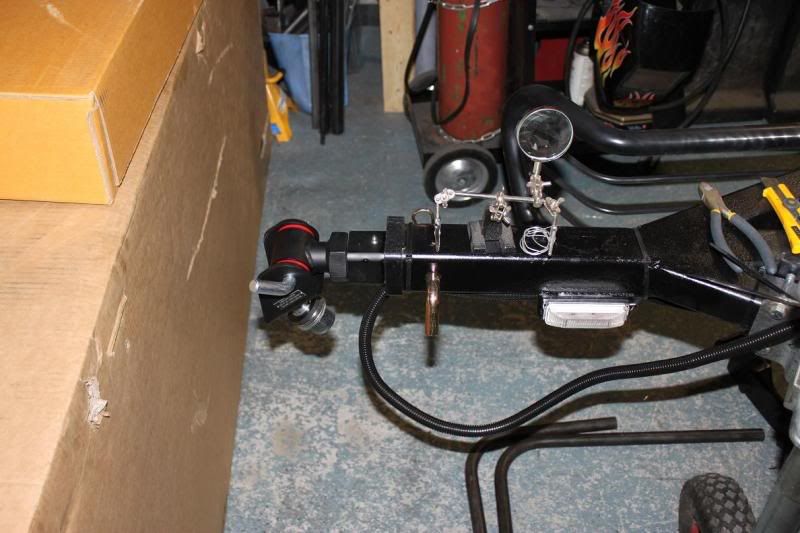

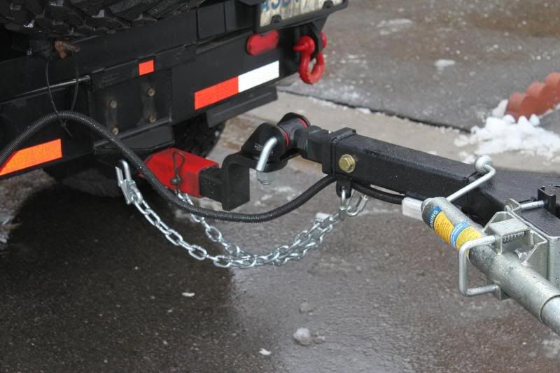

To be able to have trailer independent from the vehicle I went with MaxCoupler from Adventure Trailers:
Installed:
Operational with 4" drop (in reverse) ball mount:
