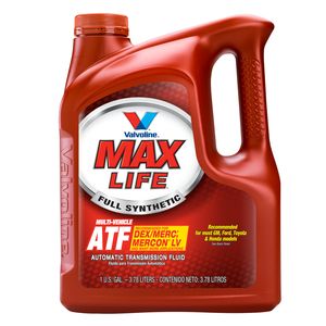

Often seems to be that a flush is about the worst thing you could do, at this point. That cruddy fluid is what is keeping it working. Best stopgap I know is a partial fluid change, using a trans fluid formulated for high mileage vehicles. It's modified a bit to help give a better grip.
Some trannies a band adjustment is possible, but once you do that much surgery you might as well do the full rebuild, the cost difference isn't much more at that point.
3
http://lucasoil.com/products/transmission-products/lucas-transmission-fix
Again, these are a stopgap solution, not a repair. Start budgeting / shopping for your transmission rebuild / replacement.
