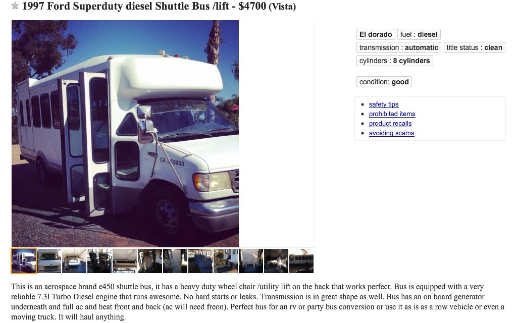

Not sure if various postings, photos and upgrades on this site have made me inspired- or insane- but I just put a deposit on this vehicle and will pick it up Tuesday, assuming no red flags appear as I continue doing some research.
Any words of wisdom/caution/advice are welcome before I sign the final paperwork.
I offered a little less than the asking price... it has a ton of miles (290k!), but seems a pretty bomb-proof platform, a professionally maintained 7.3 Powerstroke turbo diesel (it was fleet vehicle for a transit system), solid transmission, and the all-fiberglass body means no worries about rust up top. Tires look decent, tho the front pair are worn unevenly suggesting some shock/alignment issues. Heavy duty power-assist brakes, and a wheelchair hydraulic lift in the rear side door to load, well, who knows what. 60 gallon diesel fuel tank.
So.... lots of potential for transporting friends, kayaks, bikes, camp gear, etc. Professional heavy duty tow package in rear. And being a '97, no smog required in CA (at least for now- hoping laws don't change again)
Initial goal: a trip with friends/family to Baja, to see whales in 1 month. We will do a week of travel/camping with about 8 or 9 people- the amount I can legally carry in this current set up, without needing a commercial drivers license. I figure it will be easier than herding cats, I mean, caravaning down with 3 or 4 cars, esp with drivers who have never driven in Baja before.
Then, I'm looking at doing a basic RV set up, but not the 4WD lift kit (at least- not right away). Apparently that is an option with this platform. I'll need to start saving my pennies.
It may stay parked for a while in northern Baja, about 100 miles south of my San Diego home, and serve as temporary lodging while I do some work on a lot I own near San Miguel surfing beach.
So.... inspired? Insane? A little of both?
If anyone who has purchased/owns a similar rig knows something I should have a pro mechanic check out before sealing the deal, please advise!

The only thing I'd really be worried about (other than the amount of money one could put in a project like this) is the low clearance of the front door. You're going to want to lift it if going offroad, and if you do that, you might as well do the 4x4 conversion also...

Insane, nah. Cool idea. The idea is kinda cool. And since you've got land around San Miguel, very cool btw I'm admittedly jealous, you're well aware how little you actually need to get around Baja. If you keep it simple you might be able to use the rig for a while and then sell it for what you paid for it or even more!
I know that the 7.3's properly maintained can go upwards 400-500K miles. Hopefully this one had everything done properly. I had a good local diesel mech but he's gone elsewhere, but it sounds like you've got one already...
Only thing I'd look into would be the tranny, which is typically the weak point on the 7.3's. Mine went pretty much without notice. That and add gauges tranny, EGT, pyro.

Before heading to Baja I would suggest:
1- Ensuring you have a way to air up your tires reasonably quickly. These duallies tend to bury the front fairly easily and with all the people you have in there air and shovels will be your friend. Also test how hard it is to air down/up. I got caught having to dig around inside the inner dual to get the air out of a set because there was no extensions on the valve stems.
2- Take a spare fuel filter or 2 and know how to change them.
3- Only get fuel where the bigger rigs do. Don't be tempted to get fuel at the gas stations in town.
4- Take it really easy on Mex 1. With a vehicle that wide and the way the roads are very narrow and roll from side to side you get to see the trucks very closely.
