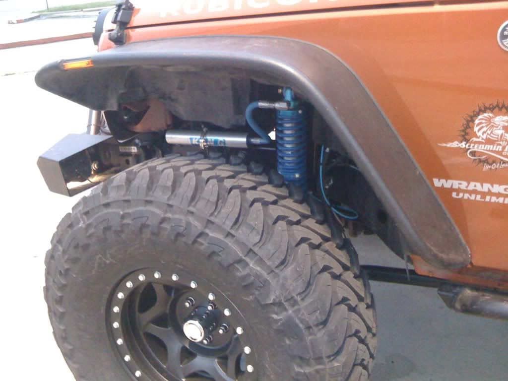

Inline6
Either will do the job. If purchasing new wheels they are not much more in the grand scheme of things. That bit of extra piece of mind is worth it to me.
As for which one, I run them both. I've had AEV wheels on the TJ for many years, no issues. I now have AEVs on the JK, again no issues. The TJ got new running gear and I went with Hutchinson.
The AEV wheels are a bit easier to put together, but the hutchinsons are not that hard. I actually might of got them done quicker, less bolts.
So why beadlock, why not? There are many things we add to our jeeps that we don't or might not need.

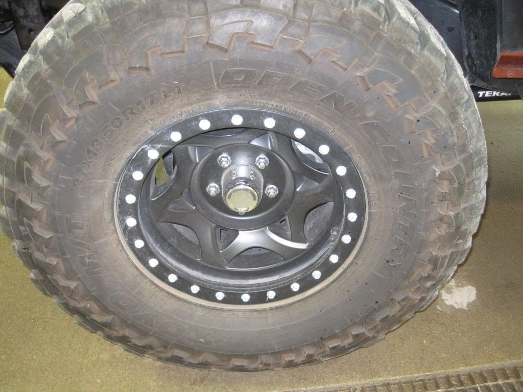

mvbeggs
+1 for the Walker Evans
+1 on the performance of the Walker Evans. They are very heavy though. My 37's and the Walker Evans are about 115lbs/ea. :Wow1:
I have aired them down to 5psi...inadvertetly. When airing down, got a piece sand in between the valve stem cap and the valve. At a stop someone pointed out that my tire looked low. Got the gauge out and was surprised to see 5 psi.
