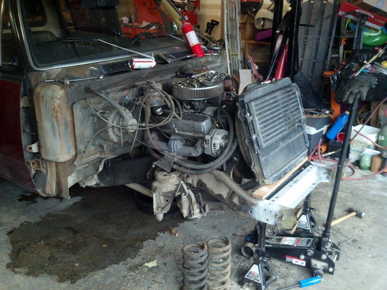

here is the subject in it's natural habitat
I started working on Friday after work, and here's where I ended up on Saturday afternoon
On Sunday, it seemed that everything was just going to bolt in place

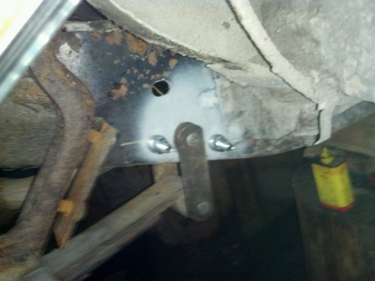

this was the difficult part for me. I talked myself into and out of the location for the bushing for what seemed like 3 or 4 hours.
I ended up setting the shackles up so that they pointed slightly forward with the axle hanging, and when I jacked up the axle to flatten out the spring, they point to the rear and still have room between the spring eye and the frame.

It holds it's self up now!
I got the other spring bushing mounted tonight, and set the truck down on it's tires. The shackle angle is a bit more vertical than I hoped for, but, it'll be serviceable.

It's back on it's wheels after changing out the 2wd cross member for the 4wd one. Had a little confusion which side was the front, but luckily, my Chilton manual had pictures of the undercarriage and I got it figured out.
