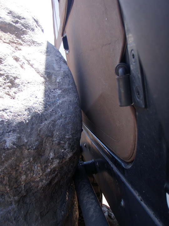

In the years I've had the AEV ones on I've never had a 'hard' impact on them. I just don't think I end up wheeling that way.
the passenger side one is pretty scraped up from this incident:
Otherwise.. all of the other damage on them is from weather/rust.
