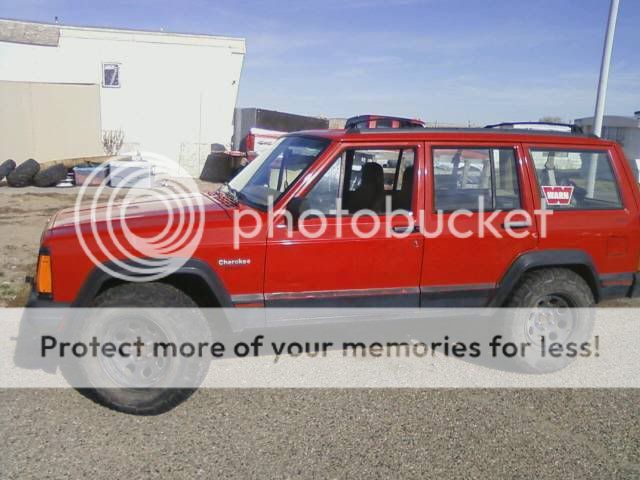

Anyway, so got another cherokee from my roomates to play with and use as a daily driver...here's the specs and no I don't know how long I will keep it, but it's fun to build it...
1996 Jeep Cherokee, 4.0HO engine, AW4 transmission, NP231 Transmission, Dana30 front and Chrysler 8.25 rear with 27 spline axles, electric windows, locks, tilt, cruise, a nice comfy ride.* When I got it , it ran fine with just a few lil mechanical issues (leaks and non working interior lights), worn springs and shocks, etc.* The good was it runs good, gets good gas mileage, seems solid with no rust and a good interior.
here's a pic when I got it...
