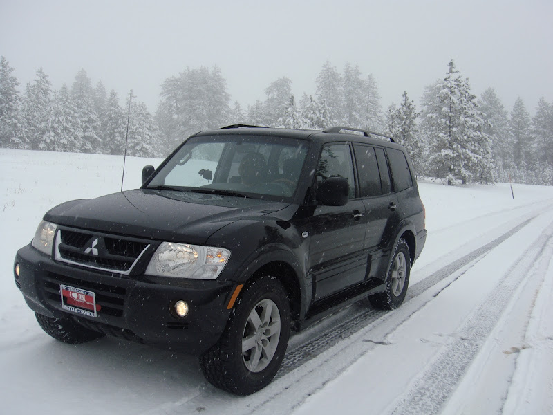

Also a new member here. Let me introduce myself, I am Zach and I live in Idaho, USA. I have always liked the Montero's and finally a few years ago I bought my first 1991 LS Gen I LWB wagon. When I "upgraded" to an FJ Cruiser, I hastily sold my 91 Montero and kind of regretted it ever since. The FJ was nice, I didn't feel like I could rough it without scratching it and eventually just traded it in on an 08 Tundra which is awesome for when I need a truck which is fairly often. I talked my wife into letting me purchase an 89 SWB Gen I to use for recreation and we recently bought her this new Gen 3 with only 30K miles. I really like it and hope to get it tricked out shortly with ARB lift and bumper. I really enjoy this forum and decided I better register as I might be lurking around for quite a while.

05 Montero
Nice.. I'd love to see how it looks with the lift and bumper. Please do post some pics, also interested in how the HD springs and lift affect the ride quality. Are you going HD in the front and rear or just front for the bar? Thanks

I can answer your questions about the lift and ride. I have the HD lift on my '01 and it is harsh at first, very harsh. After a few wheeling trips and about 1,000 miles it has softened up quite a bit. It got even better once I put the ARB bumper on the front. The nice part about itis that I can load it up with a ton of gear and family and the suspension doens't drop a bit, and it didn't drop at all in the front with the addition of the bumper.

05 Montero
Those look great with the ARB and lift. I'm definitely shooting for the look of that black one, looks sick. Thanks for the pic and comments about the suspension. What did the suspension end up costing you if you don't mind me asking? As far as I can tell springs and shocks for all four should be around $700-800 my local shop wants another $700 to install. Seems high
