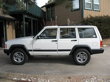

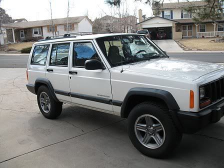

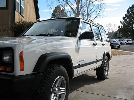

Attached are some pictures pre-lift. Sorry, I am still not the most computer literate when it comes to posting pictures.

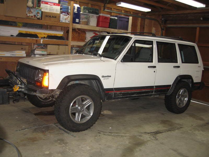

Nice wheels, here is upcountry equiped XJ with 245/75R16s:

Thanks for posting the pictures.
I think I may end up doing the SYE regardless. I like knowing that I have addressed one of the weaker spots in the Jeep drive train. Plus if I ever plan to go higher I have that addressed
T&A -
I really like the looks of the 245/75/16's but am looking to avoid any fender trimming if at all possible. On your Jeep was that due to adding the new bumper or for clearance purposes?

I only trimmed because of the bumper. I could have easily fit the tires without trimming. I dont have the sway bar hooked up for trail use and it doesnt rub even articulated and having the wheels turned full lock L or R. It does rub the inner plastic but not enough to worry about and thats fully flexed out. I only notice it because of the clean plastic. I must give credit to the 1" extended bumpstops that the Up country suspension package provides.
