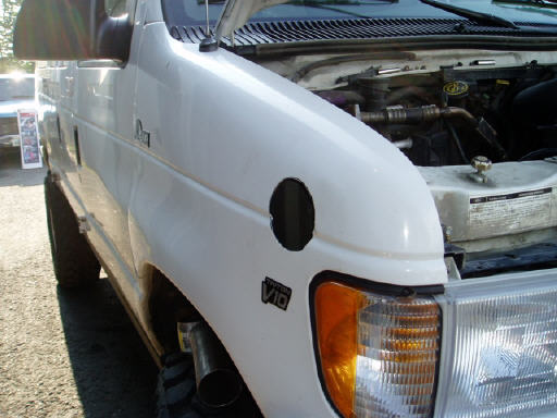

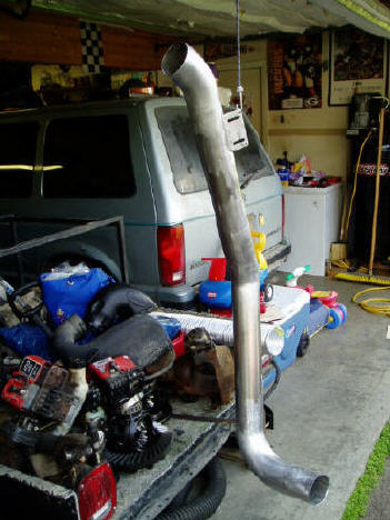

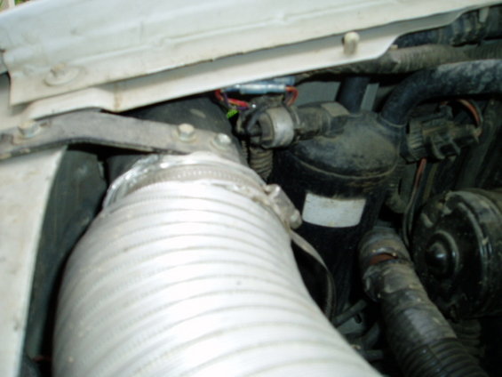

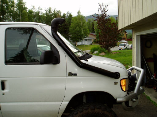

Here's mine.
Stumpalump
Dan, Did you notice any performance or throttle response improvments? I like the way you got rid of the weak sauce factory snorkle but kept the good factory air box. Also I heard that the new P/U use a air box end cap that has a larger inlet. It's suposed to snap right on to the older air boxes.
dansvan
Maybe a very small increase. Not enough to notice like "wow!" I cut the small opening off of mine and installed a flexible coupler to the drier vent. Also cut out the restrictor up by the throttle body.
