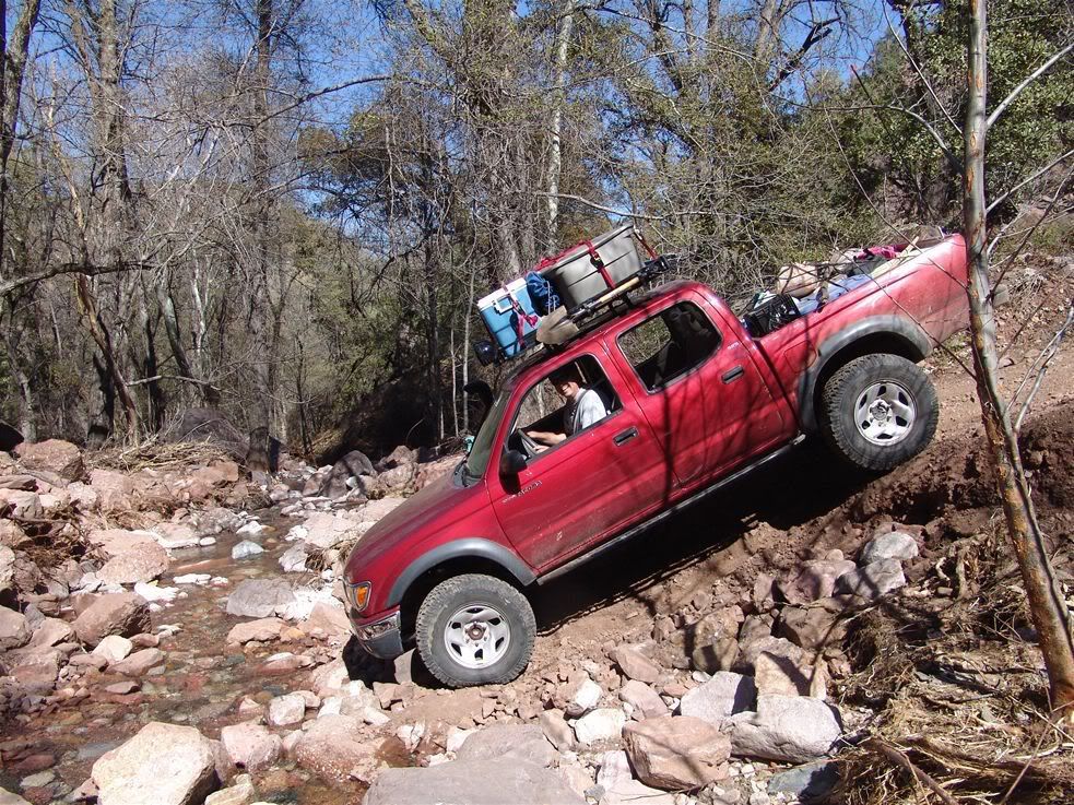

I, too, am a FORMER PreRunner. I converted my 2WD to 4WD last year. I surprised a lot of people with how far I could take my 2WD. I had the rear locker - which helps A TON! The rear locker easily doubles your 2WD capability. But as long as you're smart, you're a conservative and skilled driver, and have adequate recovery gear, and recovery knowlege, you can go far. Make sure your brakes and e-brake are good.
A word of advice - 2WD (locked or not) HATES MUD!

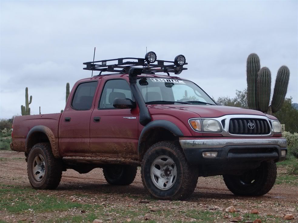

I have 2002 Prerunner with a Detriot Locker in the rear, 3" lift and sliders. I have amazed quite a few people with I take it, but knowing the limits of your skills and your trucks capabilities is key.
Every so often I get a little help from folks, but over all I'm impressed with the Prerunner.

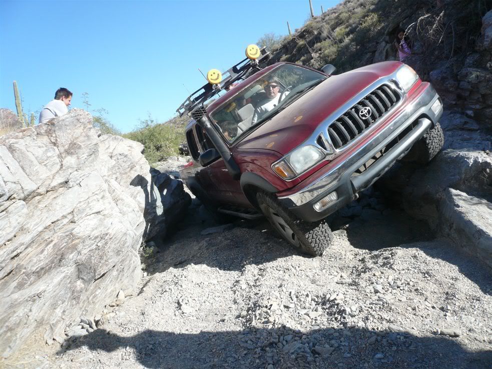

I had a prerunner with the locker at one time. The locker made a huge difference, I never had it stuck and went most places I wanted to go. Having said that I would never go back to a prerunner. If you are serious about trails and offroading then you need 4x4 (Unless your into sand and speed!). It has been pointed out that prerunners hate mud, very true. They also hate ledges. One great advantage of 4x4 is when you come to a big rock or ledge you can use your front tires to climb up it, instead of trying to push your way up with your rear wheels. That was one thing that was always a problem for me. I was actually going to convert my prerunner to 4x4 like some others have done. It really isnt as big of an undertaking as it sounds. I just finished converting a 2 wheel drive XJ to 4x4 and it was not too bad. The Tacoma is easier than that.
