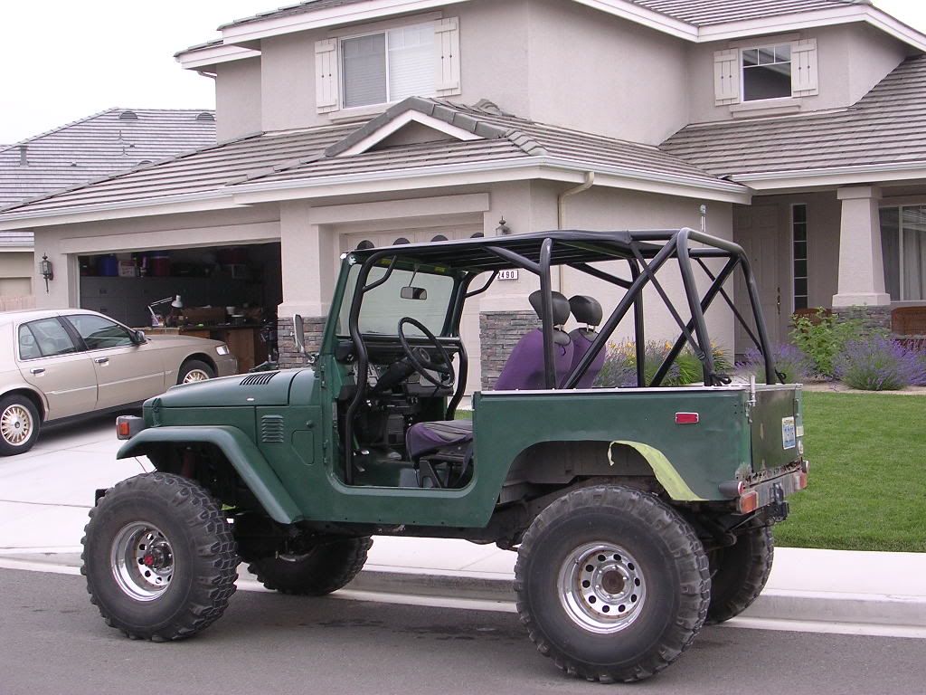

I used contrasting color tape to get an idea of what mine would look like
Then with an angle grinder equipped with a cutting wheel I slowly scored the metal several times along the cut line. Eventually the scrap just fell away. A little work with a file and some sand paper rounded the edges over.
