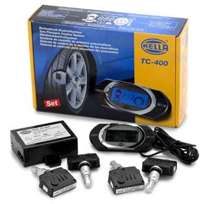

I have a Unimog U500 with Hutchinson beadlocks and two spares where I would like to attach higher-quality long-battery-life TPMS sensors internally to the beadlocking cylinders. I'm wondering if it is possible, maybe with a sensor programming tool to allow these sensors to work with any of the wide variety of TPMS sensor / display kits for trucks / trailers that can display 6 or more sensors at a time. Most of these kits come with external Schrader valve sensors that have very short (1 year) replaceable battery life and are of questionable quality (e.g. do they tolerate prolonged submersion?). I've tried asking the sensor display vendors on ebay and amazon, but I haven't been able to find anyone knowledgeable.
Here is an example of the type of sensor I would like to use:
And here are some of the possible displays:
I had thought that all of the 315MHz/433MHz TPMS sensors were cross-compatible, other than their IDs, but I am not sure if these aftermarket display products are using standardized technology in their own sensors.
