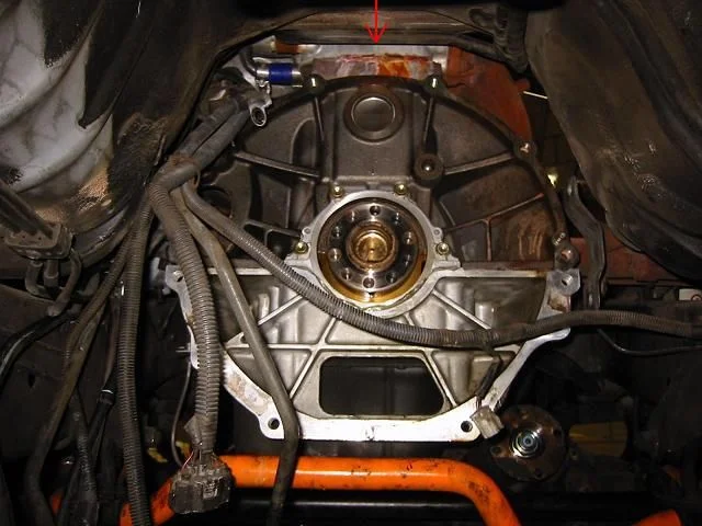

* Check head/block interface for antifreeze leaks. Take an inspection mirror and flashlight. The area that most fail is on the back of the block
attachment.php
Another indicator of a bad head gasket is to have someone hold it at 1500-200rpm and see if there are any bubbles coming up in the radiator overflow tank. You may see as few as 1 every 10 seconds to a really good flow of bubbles. No bubbles does not mean a good HG, just not a really bad one. Also look for steam or a sweet smell in the exhaust.
