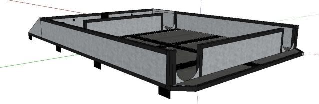

I do already have a couple of the solar showers. They work great for what they are, but are not a good means of storing and transporting water. I am looking at this as a solution to storing a relatively large amount of water, and not occupying space inside my burb. And, if on the roof, gravity kinda takes care of getting accessing the water, and could be pressurized to 10-20psi if needed for showering.
As for the UV aspect...At work we use a piping called polypro. it is an industrial process piping made to handle some pretty aggressive chemicals, and be installed outside/UV resistant. We currently have plenty for me to sneak up on enough to meet my needs.
I'm pretty sure, at this point, that this is the direction I am going for wash water storage. On most trips it'll be more water than I need. But in the rare instance where I need more, the added capacity, without impinging on my in-vehicle room, will be nice to have.

I would use the rubber expanding plugs for plumbing available at Lowes/Home Depot. They are air tight and when you are finished camping you can remove the plug to clean out the pipe.
Darrell
Seeker
I would avoid linking the two pipes. It would allow the water to build inertia, flow from high-side to low-side, and possibly upset the balance of your vehicle at an inopportune time. I might also baffle the pipes to slow/prevent sloshing action for similar reasons.

(above) What we have here is 4" PVC water pipe, epoxied at the seams and mounted using a combo of SS hose clamps (with washers and bolts through the side wall) and HD Zip-Ties looped through the factory cut outs on the wall...The red plug at the top is where it fills...I use a one gallon jug to fill it...I could use a potable water hose, but the jug works fine...The red plug does make it air tight so I drilled a tiny hole in the cap to allow venting, with no sloshing overflow...
(above) The capacity of 4" pipe is about .6 gallons per lineal foot...I have about ten feet of pipe there and with the elbows and tees, gives me about seven or eight gallons of water...
(above) The faucet is a simple PVC ball valve...The water flow is a hard smooth 3/8" diameter stream...Not wimpy...
