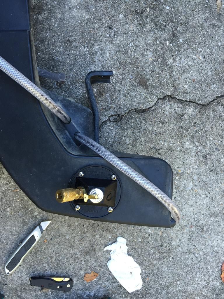

Here is the bumper after I made the holes and ran the water lines.
One line is the feed line (with a screen over the end) which will go to the pump, and the other line runs from the pump back into the bumper and attaches to the fitting for the hose attachment. Very clever.

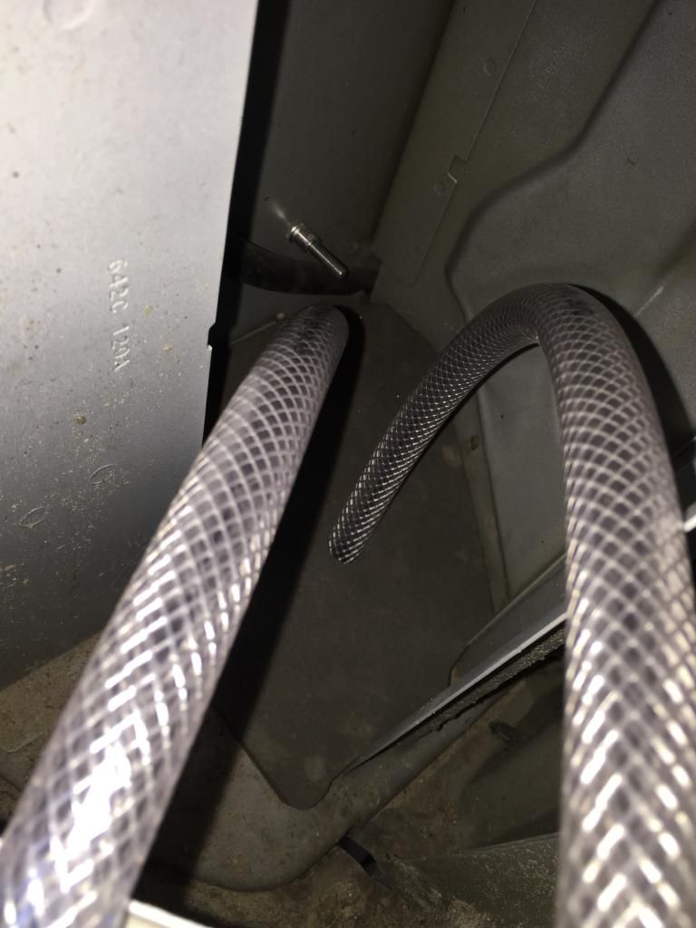

Here are the hoses from the bumper run up into the taillight cavity where the pump will go.

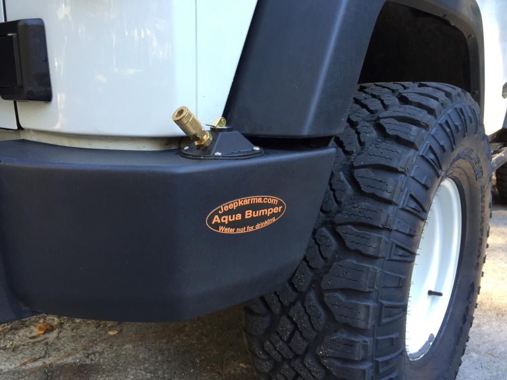

Here is the bumper back on the Jeep. I'm not super excited by how much the fitting sticks out. I'm currently looking for something that will work as a cover to keep debris out of it. I'm using an Oakley lens bag right now, but would like some sort of rubber cap in the future.

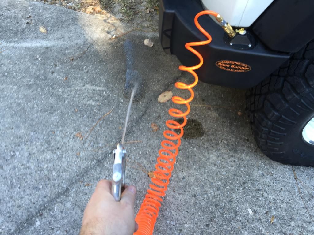

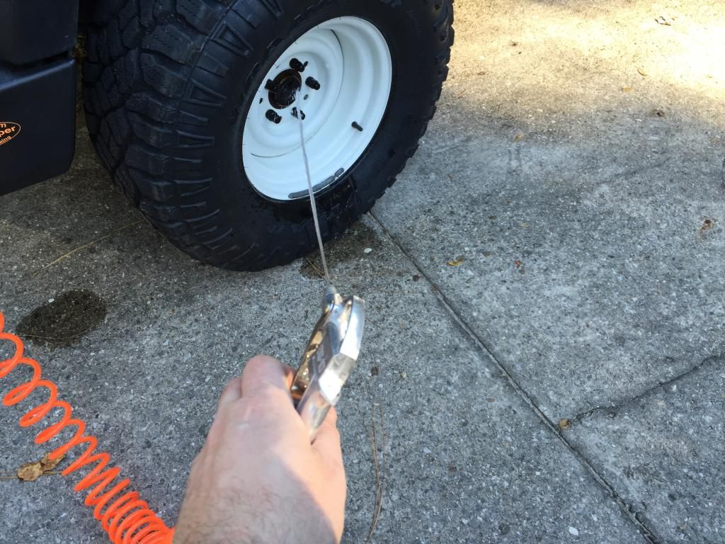

The wiring is fairly simple and the kit includes a toggle switch to kill power to the pump. The pump is designed to only come on when you depress the trigger on the nozzle.
