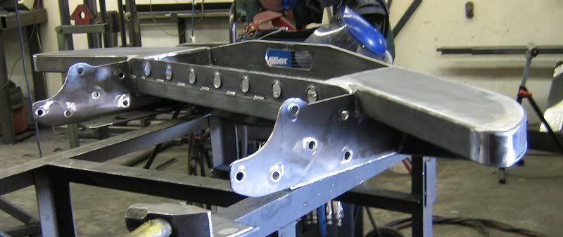

Anyway, I'm pasting a piece of a recent email exchange with some pictures from him, I don't think he'll mind the free plug!
AJ's email:
"As far as the weight goes, a winch bumper generally is in the range of 85 lbs, a non winch bumper lower 60's. If weight is a concern we can always come up with a design or alter a design and take off quite a bit. It does add a little more to the cost usually because of the extra work. But for example, normally a SlikRok weighs in around 85-87 lbs, I had a customer who wanted that design but put on a diet since he was planning on doing some desert racing in the JeepSpeed class. We managed to knock almost 20lbs off the bumper, wasn't easy and required a lot of redesign to the guts. Here's a couple pics of it.

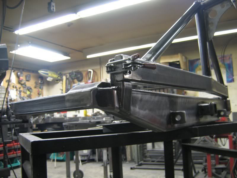

A rear bumper with a tire carrier is around 95-100 lbs total depending on the options you get. Our new swingarm design is going to be absolutely bulletproof featuring tapered roller bearings, double shear design that is simple yet absolutely tough as nails. We're also switching to rectangular steel construction of the main swingarm. Here's a quick pic showing the new swingarm setup...
As far as the position of the tire, that's no problem either. Best thing is to indicate in a pic where you'd like the tire center mount to be and I'll do my best to locate it there. Several years ago I did a split arm tire carrier, I'll see if I can find some pics for you. The biggest change was that the swingarm was located on the face of the bumper instead of on top and the receiver hitch was located much lower. We had to do that in order for the latch base to clear the tailgate when it opened. I thought of doing something similar to this but to "french" the swingarm into the top section of the bumper so the swingarm and bumper face were flush. A LOT of work involved in that so I've never built one yet.
I'm open to any and all ideas you may have. You don't have to be a draftsman or artist, any rough sketch will do. Some of the best stuff I've made has come from customer's ideas more than my own.
AJ"
