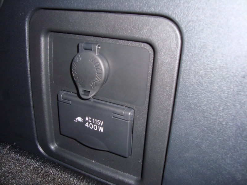

Can I get away with running a new ARB fridge off my stock Ac outlet in the back of my fj with a stock battery without trouble? I'm getting the fridge as a gift and would like to use it right away but since I work in the auto industry money for a dual set up is far away. I understand I can't venture on any long expeditions without complications but I would like to run the fridge for a long weekend. Any feedback is much appreciated.

The 08s came with 12v in the rear?
Mine only had the 110v, and a friend and I added in two 12v outlets in the rear.

Your stick outlet should be fine; however, I upgraded mine in the back of the rangie for less than $20. I used a marine quality outlet with a cap to keep the elements out when it is not plugged in.

You only have power back there when the vehicle key is on.
Plus the ARB/Engel fridges are not as efficient at 110v as they are running on 12v.
You might want to do the dual 12v outlet mod like I did, and have full time power there.

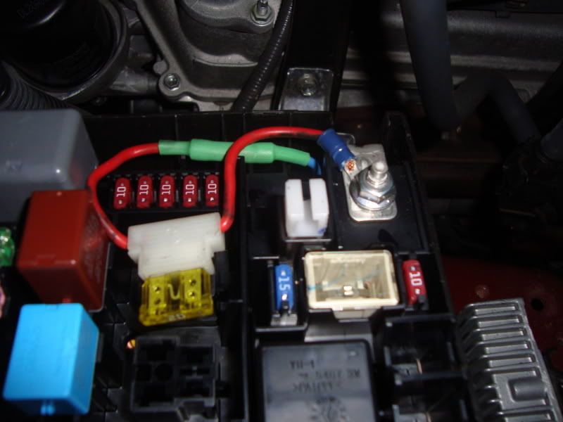

I took your advice Corey and installed a 12v outlet above my 115v on my fj.
I just ran a wire to the main fuse box under the hood with an inline fuse and the ground for the tail lights.
Can someone tell me what amp fuse to run? I need it to power a new ARB fridge. I put a 20amp fuse in there temporarily,

I believe I have a 15 amp fuse in the BlueSea aux. fusebox.
It should be in my thread I posted earlier.
