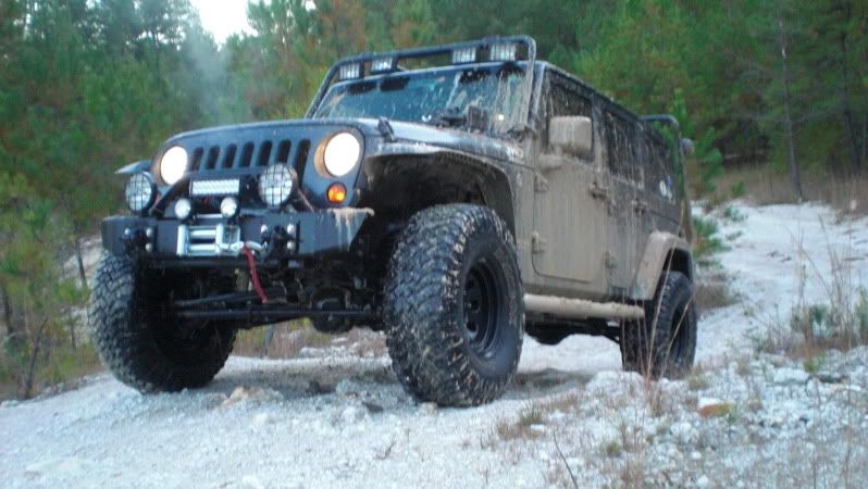

Serg5000
35's on a JKU look sick. Once I trimmed my stock fenders they really looked awesome. Well, I think so.
