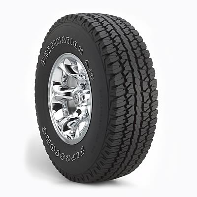

Looking for AT tire options for 14" rims. I know of BFG AT and GY Wrang AT, they can be had in 195/75R14. Anyone know of others? Any bigger ones?
The idea is to stay on the car's stock 14" rims.

Regarding your R14 tire question... If you're looking for a AT, the BFG pretty much sets the standard. Hard to go wrong there. If you're looking for more aggressive, I know a couple of the Super Swampers come in a R14. Check out the TSL Bias and Radial and the SSR.
A lot of the guys who wheel old Subaru Brats and GL's are usually looking for smaller (R13 to R15) size tires. Try some searches here: http://www.ultimatesubaru.org/forum/
Anyway, good luck!
I think I found the tires I want.
225/70R14 - Firestone Destination A/T

A lot of small trucks had 14" rims so you should be able to find tires that fit. I think there are some Goodyear or Uniroyal sizes that are sold by Wal Mart that will probably work.
ihatemybike
How about a 27x8.50R14? General makes their AT2 all terrain in that size.
Excellent! Same diameter as the Firestones, slightly narrower, lower cost and I like the tread pattern better. I have a new front runner.
27x8.50R14 (Roughly 215/75R14)
