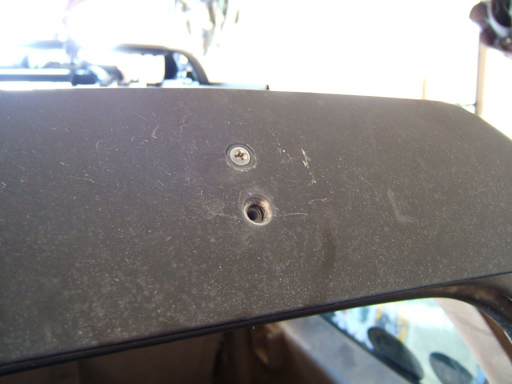

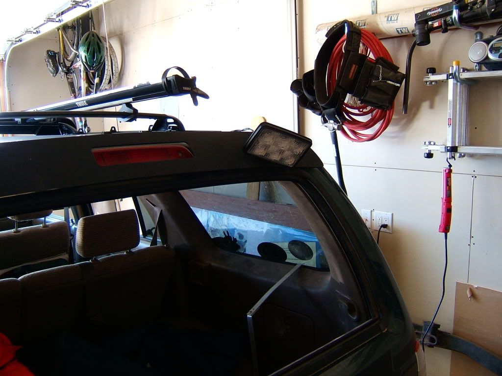

Here is how I installed mine. It is a Grote 63611 LED light
The LED is nice for the power consumption, but one just does not through the amount of light I would like. I am looking at getting a second or replacing it with a something else.

Where did you get that light? How much was it? Is it 2W or 3W LED?
