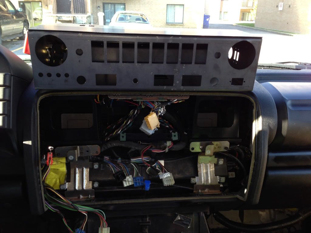

They're not wired yet, but plans as follows:
1. On board air
2. 120v inverter
3. rock lamps
4. roof lamps or aux.

Do you have a D2 radio in your D1??? Please tell me it was easy, I want to do it.
sedat
Yep!
It would have been easy had the PO not ruined the friggin harness!
Its basically plug and play.
I did it to add ipod functionality via a BMW integration unit. You can kinda see it in the bottom right corner.
I finalized the d2 seat switches today too.
