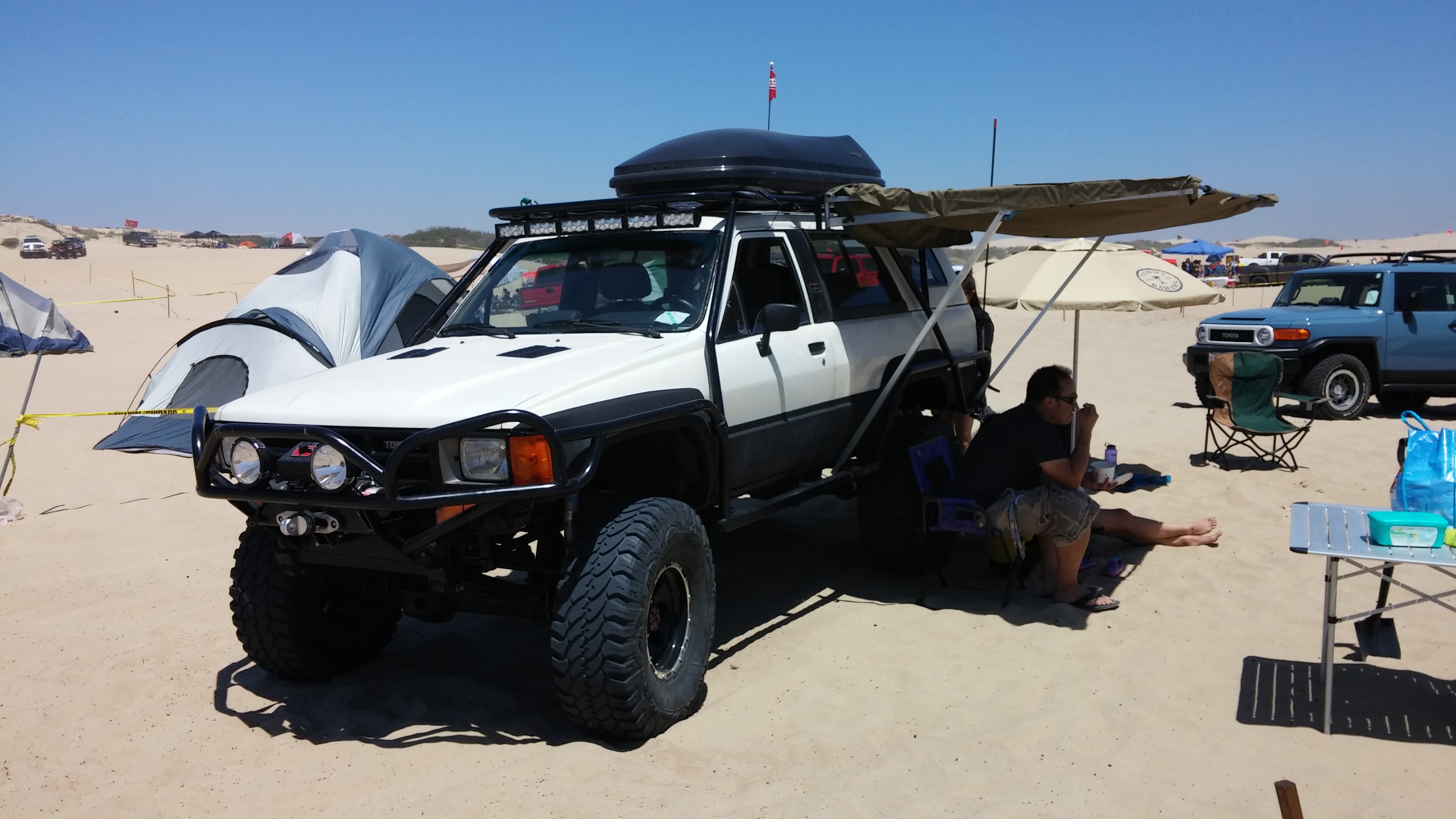

I've got a Hannibal like designed awning and the mounts are pretty strong but with high winds and all that leverage I can image it acting like a sail and ripping right off. Because of that I built some triangulated supports that mounts off the trucks slider and bumper. Now the awning is rock solid. I just took it to Pismo and it held up to the winds with out even a hint of movement.
