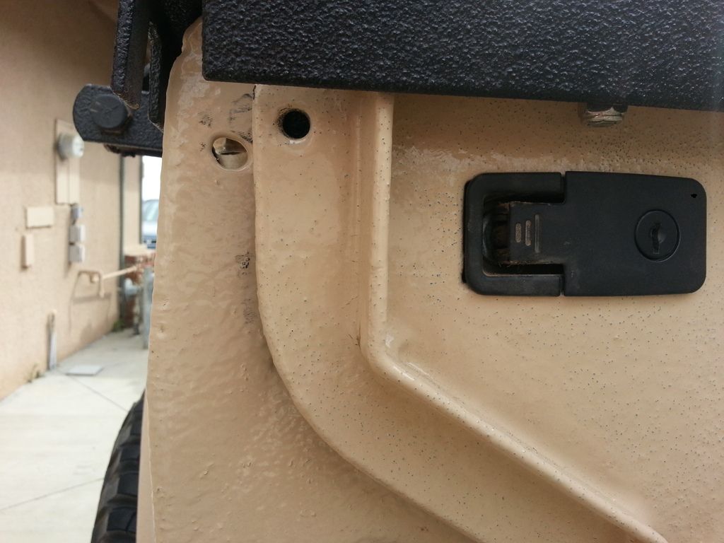

You can see the shifting here: These two holes were aligned.
This angle and the tailgate should be aligned:
Here's the opposite side:
You can see the top how much it shifted from the opposite corner:

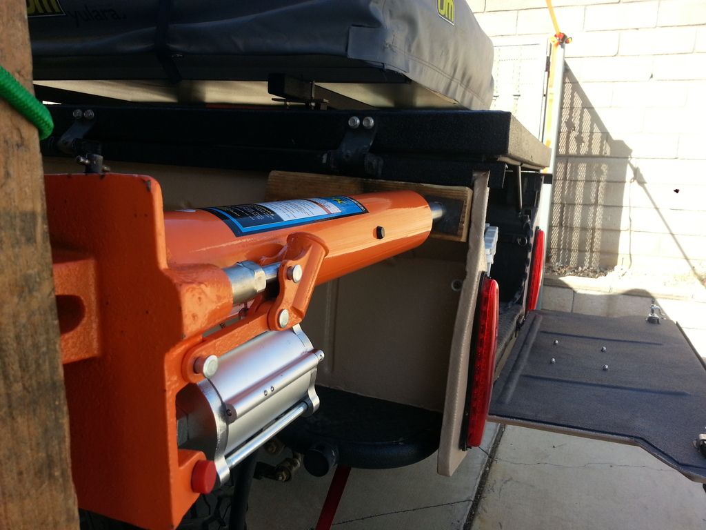

Well, I repaired the bent tub... A little ingenuity and some hydraulic muscle :sombrero:
Harbor Freight comes through again....
8ton extended length ram.
I pushed the corner towards the center of trailer while the lower portion of the trailer was held in place with straps. The corner moved easily and I was able to get it realigned perfectly back to original...

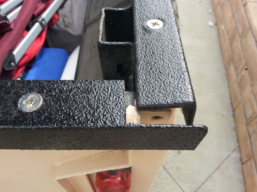

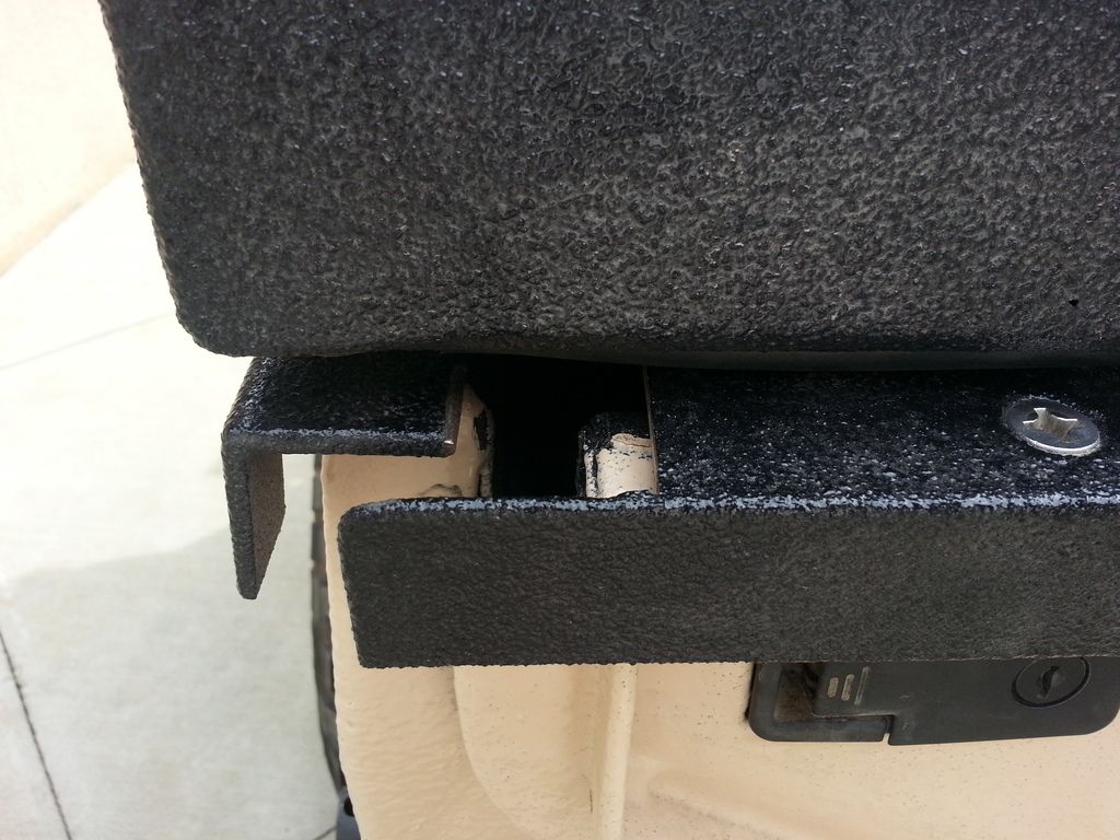

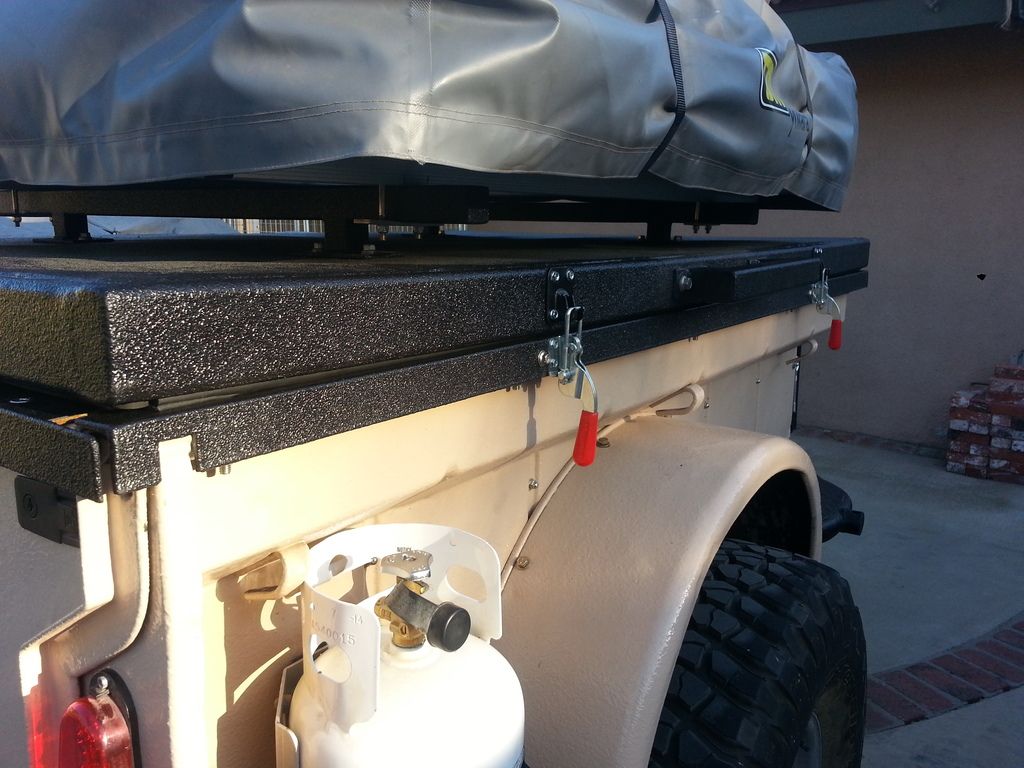

Here's the final fix..
Got the cross brace Linex'd. Came out pretty good. The top lines up actually better than before. I also added support bolts to the top angle at each hinge and latch, that really stiffened up the upper frame.
The Destaco's are much better latches that what I had before.

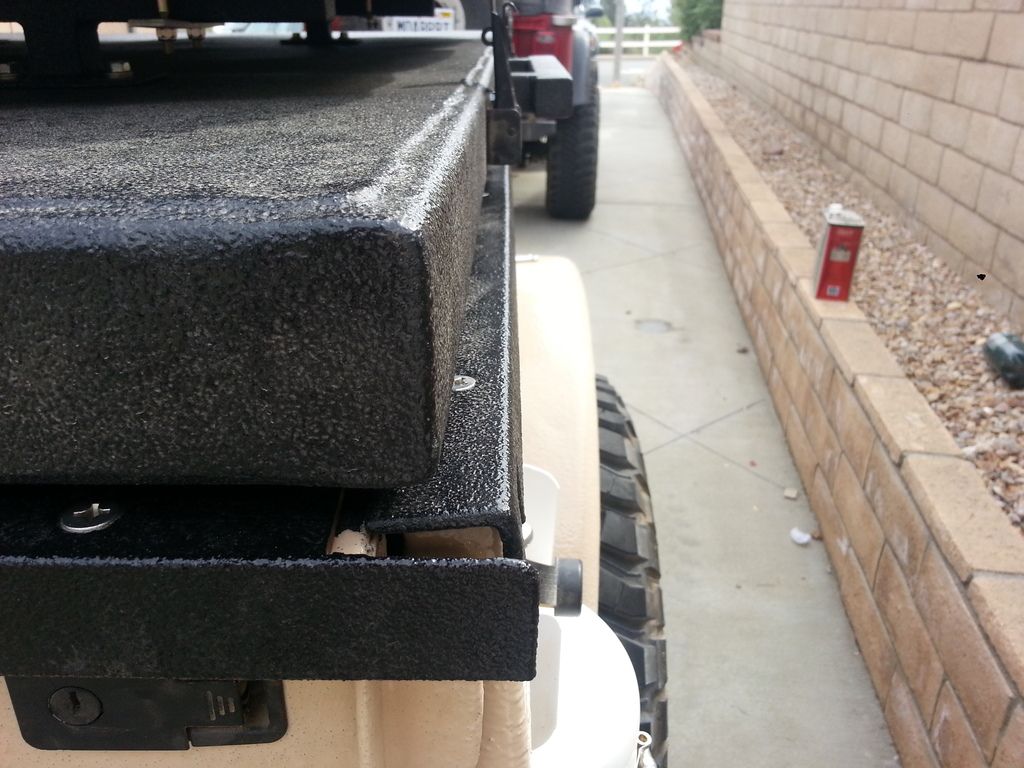

The fact that you had this happen got me nervous as I'll be traveling nearly 6,000 miles to Overland Expo and back from New Jersey so I decided to go ahead and strap it back into alignment and bolt it in place today as we had some gorgeous weather
My Actionpackers fit with 1/8 of a inch to spare and I put some rubber edging on the upright portion of the angle iron to provide some more support for the RTT
The bonus now is that for the first time ever, I can close my tailgate easily and have to bolted together very straight as compared to the way it was
