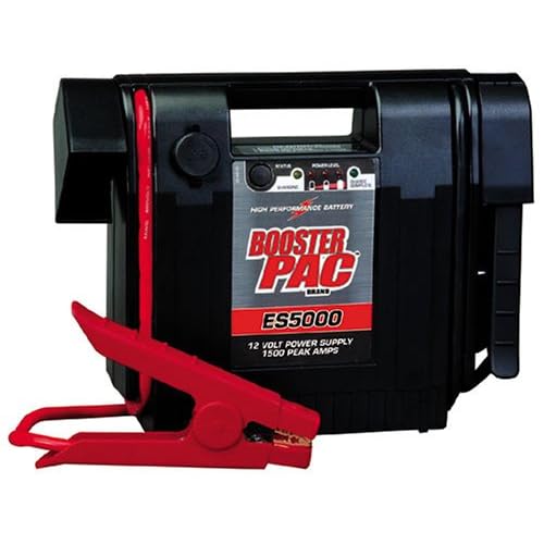

The yellow one is generically made and sold under many different brand names. I used to have a 950amp one (with those useless compressors in it) but after it failed to start my dead flat Jeep I upgraded to a 1500amp one. Last month the 1500amp started 3 small trucks and 4 x 2.8l diesel vans before it indicated that it needed to be recharged.
Have it stored strapped to the spare wheel recess in the rear of the Cherokee and use its cig lighter plug to run camping lights, battery chargers etc. Ran a 30amp wire from the accessory fuse down to it so it is constantly being topped up when driving on a camping trip. Probably not the best use for its battery life but very handy and much cheaper then running a dual battery system.
Most of its use is in starting other peoples vehicles as it is much easier just grab the starter pack then trying to position vehicles so cables will reach. Because of this and to be sure it will always start your 4.0l I would recommend getting the highest rated one you can afford.
