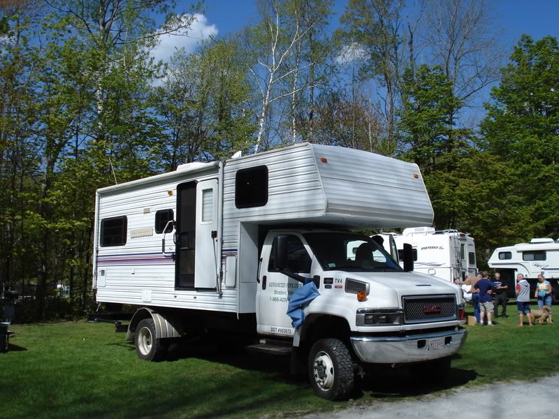

Hi I am looking for advice for good Beach Tires.
I have Kodiak 5500 4x4. My truck and camper loaded weighs 17,000. (GVW of truck 19,200). The current tires are 245/70/r19.5 load range G. I asked others how a load rated "G"----19.5" tire when "Aired down" would handle the beach
sand...The consences is they know of No One running 19.5 load rated "G" tires running the beach because the side walls are so stiff they do NOT squart to give you the additional "FootPrint" you need to go over the sand.
The beach is Sandy Neck on the Cape 65 miles away.
I am sure a large number of dually owners are running large singles on the rear . I will also use two sets of wheels and tires. The stock tires for everyday and a second set for the Beach. I am prepared to run two different size tires for the front and rear(I have enough room to carry two spare tires).
Thanks for your advice

damn lets see some pictures of that rig!

Post picks of your rig and more details on the mix of intended trips. We'll see what we can come up with.

Thanks for the responses. Here are some pictures.
They were taken at the Northeast Truck Campers Spring Jamboree. The camper is still work in progress. When finsished and I get some time I will post before, during and after photes. Camper started as Wildwood 5th wheel. Besides being used as a camper. It can be converted into a flatbed, rack body or dump. Thanks for you help in my quest for tires.
thanks joe
